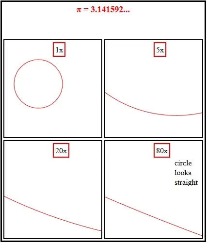

Intuitive Response (for those who don't understand the more analytical responses)
The answer is easy. We just have to zoom in. Π &ne 4 solution image
We can see at low zoom how the (purple) staircase hugs circle, but higher zoom shows it always remains a crude approximation to the circle's shrinking matching segments except near 0, π/2, π, and 3π/2. [In contrast, the (green) inscribed polygon is an increasingly good approximation and equally good at all angles.]
-- see "Simple Geometrical Explanation" below for longer but still simple explanation. The Updates at bottom add more insight once the simple geometrical explanation is not good enough for you. [Need to add more pics to clarify some aspects better.. ultimately potentially leading into something approaching a formal proof.]
The javascript code used to make the picture frames of the gif follows at the bottom. The code can be used as a starting point to make your own improved gif/animation or just single png frame. [may try to clean js code up later on as well as make more running time efficient]. I then clicked through to each pic, carefully screen captured the same bordered region for each pic, and saved to file. I integrated them into a gif using http://gifcreator.me/ (most frames got 250ms delay, but the first and the last of each of the 6 sequences got 750ms). I took that final gif and uploaded to stackexchange https://meta.stackexchange.com/questions/75491/how-to-upload-an-image-to-a-post
In case the above very short explanation + pic is not enough, here is a longer re-explanation (leveraging pic):
Simple Geometrical Explanation:
[To get a simple explanation, we have to have a simple approach. A circle is a simple, easy-to-make shape, and this problem was studied ages ago with simplified reasoning.]
The question posed is why can't we approximate the length of a circle [PI = the length of a circle of diameter 1] by measuring the length of a "staircase" path that hugs the circle tightly?
The answer is simple:
If we aim to find the length of some near straight object from point A to point B, we want to measure as closely as possible to a straight path from A to B (see green/red quasi-overlap). We won't get the correct answer if instead, like the staircase approach above (purple), we measure from A to a point far off to the side and then from that point to B. This is very intuitive.
Now, to approximate the length of a circle, we replace the whole circle with many little straight paths following closely the shape of the circle (green). We do use a single direct connecting (green) piece between every two adjacent points A and B (A and B, not pictured, would be where adjacent gray lines intersect red circle) instead of using the inaccurate 2-piece (purple) step. Do observe a key point that makes this work out: any little arc of a circle, as with any small section of any simple curve, becomes nearly indistinguishable from a similarly sized line segment when these are short enough.
[Recap:] So, at any angle around the circle, for large N, a small green line segment ≈ small red arc. Meanwhile around most of circle 2 right angled purple line segments are clearly > matching red arc, no matter N. This is why the green approximation gets very close to π while the purple approximation is way off at 4. [Note: green π = N sin (pi/N) and is easily derivable from basic geometry by summing 2*N pieces that are opposite radial triangles with hypotnuse .5 and central angles 2π/(2N).]
[Finally, I apologize if you can't discern green from red. I may change colors later but found these convenient and generally easy to differentiate.]

Update 1:
After seeing the picture (eg, green/red overlap zoom 80x for large N), we still might wonder (and not outright accept) why the two sides of right triangle don't equal the hypotenuse, why doesn't a+b=c?
Well, with basic Euclidean geometry, we can prove Pythagoras Theorem; thus, we are asking, given a2+b2=c2, why doesn't a+b=c? Well, a simple counterexample of 3,4,5 shows that Pythagoras holds where the other simpler equation doesn't (3+4≠5), so a+b=c is not true generally. That being the case, we can't conclude PI=4.
Update 2:
The main issue with the right triangles is this, no matter how small they get and how many, those within a given region (in neighborhood of a given angle), even as you go to infinitely many of them, adding the lengths of the (purple) legs of each one will be a significant fraction extra than by taking the straight (green) hypotenuse path. This fraction goes to a given number (say 30%-50% extra near the +-45 degree region.. as a lower bound) that is clearly not zero. This is for every single triangle in that region no matter how many you make, so it factors out of all of them (distributive property). 4 is an upper bound all right. Any shape you use (a saw/staircase), inside or outside the circle, will converge to a higher number as long as it isn't a straight path distance as you get closer and closer to the circle. Distance is defined as the smallest path from point A to B. Every other path shape that does not approach it in value (below epsilon for all n>N0) but instead stays above some lower bound difference against that straight line path (within some "wide" angle region of circle) cannot come arbitrarily close to specifying π. ..this response could use another pic that shows calculations of length and how clearly all "right triangles" within a "wide" region of circle (except tightly at N, E, S, W) will add extra length. A given region of circle, and given path definition, can have a higher-than-zero lower bound plucked out (distributed out) of that region. Being a clear value higher than zero higher than pi in a "wide" region of circle is a sure way to not approach π.
Analysis goes further than Euclidean geo ever could.. but you are still getting at the same basic thing
To get π, you use a straight line path connecting the many points on circle. Tiny circular arcs straighten out and approach that path ("difference" bounded below only by 0) any other poly path that clearly does not approach straight line ("difference" bounded below by number higher than zero) will thus not approach circle. Problem is that there is no real definition of length of a curve we are going on. Euclidean geom defines length more loosely. It gives definite values for some shapes, including lines, circles, etc. These match the physical world notion of length. Analysis (and there are different variations, some of which go even further) goes further than Euclidean Geo and define more generally a distance definition for arbitrary curves. To prove using those tools, you have to first know precisely how length is defined there and then build the formal argument upon it. With Euclidean (intuitive) view and not diving more formally than that, you are limited to a certain amount of hand waving. You really must define length for a curve precisely if you want a precise argument.

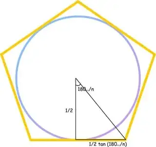

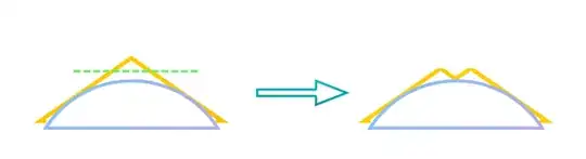

Summary: The construction at the top (pi=4) merely shows an upper bound. It's an upper bound but it is very easy to come up with a lower but still upper bound to the circumference. The =?4 construction doesn't prove or disprove very much more about the length of the circle besides providing an upper bound pi<4. It certainly doesn't prove =4. Finally, we always should rely on physical "experimentation" to support the meaningfulness of any construction.
If we use a hexagon circumscribed around the circle, we can find a different upper bound rather easily that would be lower than 4; hence proving that the construction above is merely an upper bound (of which there are an infinite number.. including pi=?10000, by using a path that weaves all over a small area between a square and circle) but certainly not the lowest upper bound.
To get closer to discovering pi, we can then also use a mirrored complementary approach of increasing lower bounds via inscribed polygons of an increasing number of sides. However, arguably we could "weave" as well with the incribing to create such a "lower" bound approaching say 4 from below! [Ie, by weaving, we can inscribe a weaved path that ends up being arbitrarily large in measurement despite nicely fitting inside the tightening space between the circle and polygons.]
Ultimately, one key to getting sanity is to postulate/believe that the shortest distance between 2 points is a line (Euclid did this a long time ago). We observe, for example, that the accepted height of a person involves a procedure of using a taught measuring stick or, generally, measuring curves by tightening a flexible measuring device as far as it can be tightened while still hugging (remaining within a certain area of) the curvy item being measured. This procedure is very easy to do for a circle made of an iron ring, for example, and would give a very close approximation to pi. This exercise also shows that math is not reality. Math is built upon postulates and definitions (something must be accepted as being true), but these postulates need not match our physical world in order to remain logically consistent. To say meaningful things about the physical world, we must judge the reasonableness of mathematical postulates and definitions [phv3773 noted in an answer how definitions were missing, while others have also noted collectively many of these points]; we must determine just what is a reasonable set of postulates to start with in order to reach a reasonable meaning of length of a circle (ie, of the value of pi). We might conclude for example, that the usual inscribed/circumscribed approach relies upon a framework closer to reality because in fact it approaches the tape measure "experimental" results arbitrarily close.

Proof by contradiction
What's the perimeter of a regular polygon with an inscribed circle of unit diameter?
It has apothem equal to radius (distance between a side and the center): $\frac{1}{2}$
The central angle in front of a side is $\frac{360^\circ}{n}$.
Next to 180 it says "deg"
So a whole side is of length $2\cdot \left(\frac{1}{2}\tan{\frac{180^\circ}{n}}\right)$
There are $n$ sides, so it has perimeter ${n\tan{\frac{180^\circ}{n}}}$
The folding method (details at the end of the answer) preserves perimeter. So the polygon's perimeter equals the circle's circumference
Dividing by the diameter (the definitions of $\pi$), which is $1$, we get $\pi = n\tan{\frac{180^\circ}n}$
(which is actually only correct when $\lim_{n\to \infty}$! Think of how different choices of $n$ can change the calculated value of $\pi$!)
The contradiction
Replace the square with a triangle, and apply the same steps and you'll see that $\pi = 3\tan{\frac{180^\circ}{3}} \approx 5.196$
Replace the square with a hexagon, and apply the same steps and you'll see that $\pi = 6\tan{\frac{180^\circ}{6}} \approx 3.464$
Replace the square with a enneadecagon (19-gon), and apply the same steps and you'll see that $\pi = 19\tan{\frac{180^\circ}{19}} \approx 3.171$
Conclusion
This way to calculate $\pi$ by assuming $\text{circumference} = \text{perimeter}$ is invalid, as it contradicts with itself.
Further description
The green line bisects the distance between the angle and the arc. It represents folding. If we repeat this multiple times (applying to newly formed vertices in each step), we'll find that the circle's circumference is equal to the polygon's perimeter, because, after every step:
  • all vertices become closer to the circle
  • the number of vertices doubles
  • the perimeter stays constant
The polygon-part in the image is from a pentagon. No matter what the angle is or how many sides the polygon has, we can fold each vertex infinite times and find "circumference = perimeter", but since every polygon would have a different perimeter, we have self-contradiction.
Consider the approximation to the circumference (to Pi) that is suggested by the question. Call that a step-wise approach.
Consider the approximation of using an inscribed or circumscribed regular polygon to approximate the circumference. Call that a polygon approach.
Let's note the following.
1: A step approach relies entirely on 90 degree angles.
2: Meanwhile a regular polygon approach has the angles obtuse and actually approach 180 degrees as the number of sides increases.
3: If we zoom in, we can no longer discern a tiny segment of the circle from a straight line.
In the step construction, when we are at a very high iteration count, each step starts at one end of a tiny segment and ends at the other end. In some cases as we go around the circle, the vertical step component will be very short and then a long horizontal component. In these cases, the step construction will approach the circle's "nearly straight" tiny segment in length. But in many other cases, the up step will be longer. In the extreme case, the up vertical part is exactly as long as the horizontal part. In this extreme case, we are approximating the length of the "flat" hypotenuse of an isosceles right triangle to be equal to the sum of the 2 legs. Clearly that is a bad approximation. These cases with many fairly bad approximation occur regularly.
Contrast with the polygon approach. Here we approximate the length of the longest side of an isosceles triangle to be the sum of the lengths of the 2 equal sides. In all cases, this is a good approximation, since the polygon must necessarily be almost 180 degrees to achieve "continuity" in slope to the next segment. (It's a convex polygon).
Summary: The step approach must use 90 deg pseudo-triangles where the short 2 legs are use to approximate the long "nearly straight" leg. This is clearly insufficient in many cases, particularly when the triangle is near isosceles. In contrast, in the polygon approach, the triangle always has one angle approaching 180 degrees so that sum of the 2 short legs is necessarily about the same (in terms of relative percentages) as the length of the "nearly straight" leg.
