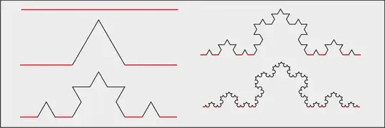

The Koch curve is normally constructed by taking a line segment, replacing the middle third with two copies of itself forming legs in an equilateral triangle, and then repeating this recursively for every subsegment. See image below. At every step, the length of the curve is multiplied by $4/3$ so the final length is infinite.
Notice that every line segment undergoes the construction of the Cantor set: enter image description here

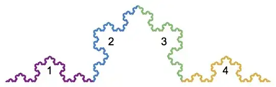

These functions map the Koch curve onto the four sub-parts below

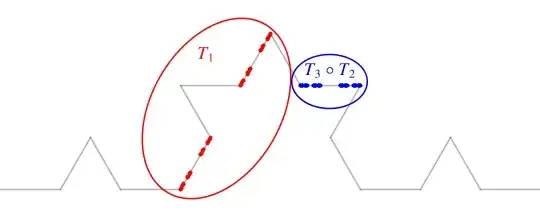

If, for example, the sequence has only 1s and 4s, and no 2s or 3s, then we get a point in Cantor's ternary set lying on the unit interval. If the sequence start with a 2 and then contains only 1s and 4s, we generate a point in the red Cantor set shown below; this is exactly the image of the ternary Cantor set under the function $T_2$. If the sequence starts 3, then 2, then contains only 1s and 4s, we generate a point in the blue Cantor set below; this is exactly the the image of the ternary Cantor set under the function $T_3 \circ T_2$.

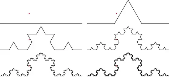

Finally, if we have any other sequence of 1s, 2s, 3s, and 4s, then we generate some other point on the Koch curve that is not in any of your Cantor sets. There are uncountably many such points. I suppose the simplest one to find explicitly corresponds to the sequence containing only 2s, which is exactly the fixed point of $T_2$. To find it, we need only solve $$T_2(x,y) = (x,y),$$ which yields $(5/14,\sqrt{3}/14)$. That point is shown in red in the sequence of approximations below.

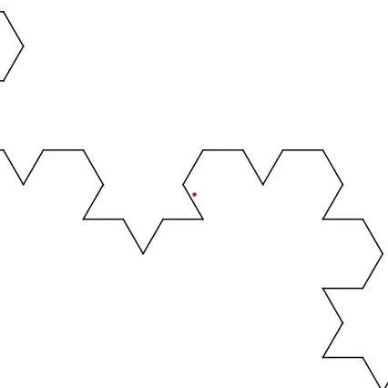

If we zoom into the last picture on the red point so that it's centered in a square of side length 0.04, we get the following:
Thus, the edges keep jutting out closer to the point but never actually hit it. It's in the limit but not on any of the edges.
