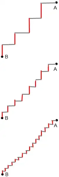

Say you want to get from point A to point B.
an image
Here is a way to do it, where red is vertical movement and grey is horizontal movement.
another image
Now say you split the path up like this. Note that it is the same length, as you can see from the color of the lines:
another image again
You can continue to do this... (note that the path still continues to stay the same length):
yet another image
And if you continue forever, the path will become diagonal.
yet another image again
But now there's a problem. This is contradicting the Pythagorean theorem:
so many images!
I know the Pythagorean theorem is true and proven, so what is wrong with this series of steps that I went through?

The problem here is that the limit of the lengths is not the length of the limit. One has assumed that the sequence of lengths $x+y,x+y,x+y,\ldots$ converges to the length of the hypotenuse in the fake proof.
By splitting the path you have essentially created lots of little triangles. You still need to apply Pythagoras' theorem to each one. If you do, then you will get the correct answer.

  • Hi, I still have problem in this. A line is made up of dots. If we shrink the triangles small enough into dots, why cannot it be a straight line? – Chin Huan Dec 28 '16 at 05:46
  • @ChinHuan you cannot shrink them small enough. Dots are infinitely small in 2 dimensions and lines are infinitely small in 3 dimensions. So there will never be a combination of lines that can be small enough to be a dot. – Jess Bowers Jul 23 '18 at 12:25
