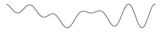

However, if we try to apply the same logic to compute the area of a 2d object in 3d space we run into problems. For instance consider some curved surface in 3d space.
2d surface
For a curved surface, we cannot find any rectangles perfectly contained in or perfectly containing any piece of the surface. Hence we don't have the earlier elementary method to argue that the area must be between two values that we can easily compute, so we must use a different method of approximation. If the method of approximation is not well chosen, we run into similar problems as in the staircase paradox.
