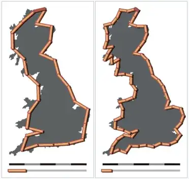

This seems to be a derivative of the well-known coastline paradox
When you "paint" the Koch snowflake with a line of nonzero width, you are effectively sampling the fractal at a resolution of the line width. By doing so, you do not obtain the length of the infinite fractal, but instead a fractal with finite iterations, therefore obtaining a finite length.
This is analogous to the coastline paradox, which states that sampling a coastline at a higher resolution will yield a longer coastline than when the coastline is sampled at a lower resolution. In the example given by Wikipedia, sampling the coastline of Great Britain at 50km resolution gives a coastline length that is 600km longer than if it is sampled at 100km resolution.

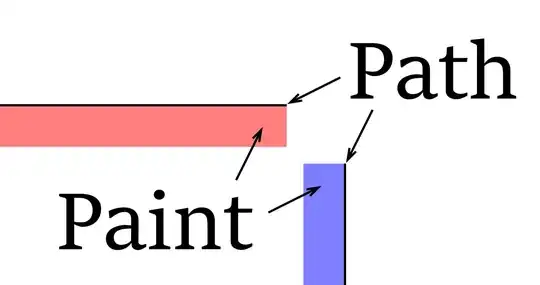

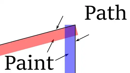

but on the other hand, you can't paint it's sides (infinite perimeter×thickness=infinite surface area)... What am I getting wrong?
The assumption behind this formula is that painting the edges of some form means replacing each edge by a rectangle.
(One edge length of each rectangle is the "thickness" of the pen and the other edge length is the length of the edge which is replaced by the rectangle.)
However this assumption is not correct because at the corners of the original form the rectangles would overlap when painting like this.
To calculate the real area of the "painted edge" you first have to define how the corners of the form are painted. This image from the manual of a graphics program shows different examples how this can be done. And it is obvious that the "painted" area will be different in the three cases shown in the manual.

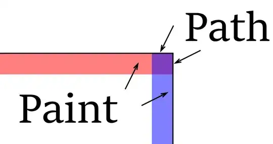

Overlap
Paint paradoxes like this stems from the unspoken assumption that every surface will be painted with a layer of paint of a finite thickness.
There are two errors in this:
  1. Adjacent surfaces will have overlapping paint in concave corners.
  2. It is not certain there will be enough room inside the figure to reach the prescribed thickness of paint.
These errors may apply to every shape, no matter if fractal or not, finite or infinite.
For the paradox to work, every segment of the infinite path must be entirely covered with an evenly thick layer of paint. And if these segments were not joined but instead floating freely, then this condition could be fulfilled.
But these segments are not floating freely; they are joined. And with that, the layers of paint from neighbouring segments will bump into each other.
Even worse is when neighbouring paths start to interfere with each others' layers of paint, such that the paint ends up outside the shape.
With this the paradox has broken down and it is easy to see the faulty assumptions that led to its erroneous conclusion.
