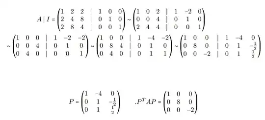

Indeed, here is the image uploaded by el.Salvador there:

I think I have the energy today to fill in the details of this png image of a calculation
from this question: Finding $P$ such that $P^TAP$ is a diagonal matrix
$$ P^T H P = D $$ $$\left( \begin{array}{rrr} 1 & 0 & 0 \\ - 4 & 1 & 1 \\ 0 & - \frac{ 1 }{ 2 } & \frac{ 1 }{ 2 } \\ \end{array} \right) \left( \begin{array}{rrr} 1 & 2 & 2 \\ 2 & 4 & 8 \\ 2 & 8 & 4 \\ \end{array} \right) \left( \begin{array}{rrr} 1 & - 4 & 0 \\ 0 & 1 & - \frac{ 1 }{ 2 } \\ 0 & 1 & \frac{ 1 }{ 2 } \\ \end{array} \right) = \left( \begin{array}{rrr} 1 & 0 & 0 \\ 0 & 8 & 0 \\ 0 & 0 & - 2 \\ \end{array} \right) $$ $$ Q^T D Q = H $$ $$\left( \begin{array}{rrr} 1 & 0 & 0 \\ 2 & \frac{ 1 }{ 2 } & - 1 \\ 2 & \frac{ 1 }{ 2 } & 1 \\ \end{array} \right) \left( \begin{array}{rrr} 1 & 0 & 0 \\ 0 & 8 & 0 \\ 0 & 0 & - 2 \\ \end{array} \right) \left( \begin{array}{rrr} 1 & 2 & 2 \\ 0 & \frac{ 1 }{ 2 } & \frac{ 1 }{ 2 } \\ 0 & - 1 & 1 \\ \end{array} \right) = \left( \begin{array}{rrr} 1 & 2 & 2 \\ 2 & 4 & 8 \\ 2 & 8 & 4 \\ \end{array} \right) $$
$$ H = \left( \begin{array}{rrr} 1 & 2 & 2 \\ 2 & 4 & 8 \\ 2 & 8 & 4 \\ \end{array} \right) $$ $$ D_0 = H $$
$$ E_j^T D_{j-1} E_j = D_j $$ $$ P_{j-1} E_j = P_j $$ $$ E_j^{-1} Q_{j-1} = Q_j $$ $$ P_j Q_j = Q_j P_j = I $$ $$ P_j^T H P_j = D_j $$ $$ Q_j^T D_j Q_j = H $$
$$ E_{1} = \left( \begin{array}{rrr} 1 & - 2 & 0 \\ 0 & 1 & 0 \\ 0 & 0 & 1 \\ \end{array} \right) $$ $$ P_{1} = \left( \begin{array}{rrr} 1 & - 2 & 0 \\ 0 & 1 & 0 \\ 0 & 0 & 1 \\ \end{array} \right) , \; \; \; Q_{1} = \left( \begin{array}{rrr} 1 & 2 & 0 \\ 0 & 1 & 0 \\ 0 & 0 & 1 \\ \end{array} \right) , \; \; \; D_{1} = \left( \begin{array}{rrr} 1 & 0 & 2 \\ 0 & 0 & 4 \\ 2 & 4 & 4 \\ \end{array} \right) $$
$$ E_{2} = \left( \begin{array}{rrr} 1 & 0 & - 2 \\ 0 & 1 & 0 \\ 0 & 0 & 1 \\ \end{array} \right) $$ $$ P_{2} = \left( \begin{array}{rrr} 1 & - 2 & - 2 \\ 0 & 1 & 0 \\ 0 & 0 & 1 \\ \end{array} \right) , \; \; \; Q_{2} = \left( \begin{array}{rrr} 1 & 2 & 2 \\ 0 & 1 & 0 \\ 0 & 0 & 1 \\ \end{array} \right) , \; \; \; D_{2} = \left( \begin{array}{rrr} 1 & 0 & 0 \\ 0 & 0 & 4 \\ 0 & 4 & 0 \\ \end{array} \right) $$
$$ E_{3} = \left( \begin{array}{rrr} 1 & 0 & 0 \\ 0 & 1 & 0 \\ 0 & 1 & 1 \\ \end{array} \right) $$ $$ P_{3} = \left( \begin{array}{rrr} 1 & - 4 & - 2 \\ 0 & 1 & 0 \\ 0 & 1 & 1 \\ \end{array} \right) , \; \; \; Q_{3} = \left( \begin{array}{rrr} 1 & 2 & 2 \\ 0 & 1 & 0 \\ 0 & - 1 & 1 \\ \end{array} \right) , \; \; \; D_{3} = \left( \begin{array}{rrr} 1 & 0 & 0 \\ 0 & 8 & 4 \\ 0 & 4 & 0 \\ \end{array} \right) $$
$$ E_{4} = \left( \begin{array}{rrr} 1 & 0 & 0 \\ 0 & 1 & - \frac{ 1 }{ 2 } \\ 0 & 0 & 1 \\ \end{array} \right) $$ $$ P_{4} = \left( \begin{array}{rrr} 1 & - 4 & 0 \\ 0 & 1 & - \frac{ 1 }{ 2 } \\ 0 & 1 & \frac{ 1 }{ 2 } \\ \end{array} \right) , \; \; \; Q_{4} = \left( \begin{array}{rrr} 1 & 2 & 2 \\ 0 & \frac{ 1 }{ 2 } & \frac{ 1 }{ 2 } \\ 0 & - 1 & 1 \\ \end{array} \right) , \; \; \; D_{4} = \left( \begin{array}{rrr} 1 & 0 & 0 \\ 0 & 8 & 0 \\ 0 & 0 & - 2 \\ \end{array} \right) $$
