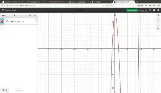

Note that the matrix $H$ has characteristic polynomial $x^3 - 10x^2 + 6x + 12$ and (irrational) eigenvalues
$$-0.8119658377479428698001875737, \; \; \; \; 1.605232411407321548171091093, \; \; \;9.206733426340621321629096481 $$
