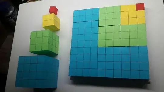

This picture shows that $$1^2=1^3\\(1+2)^2=1^3+2^3\\(1+2+3)^2=1^3+2^3+3^3\\(1+2+3+4)^2=1^3+2^3+3^3+4^3\\$$ this is handmade of mine
Khosrotash
  • 24,922
