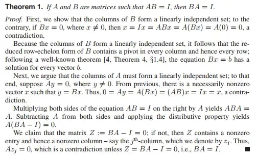

  • @littleO 's answer is very useful. However, I found another way of obtaining the result without abstract linear algebra, by considering the process for finding the inverse of a matrix, which I gave an answer here. – Tran Khanh Dec 21 '23 at 06:29

The following proof appears in the article A Short and Elementary Proof of the Two-sidedness of the Matrix-Inverse [Paparella, P., College Math. J. 48 (2017), no. 5, 366-367; MR3723713] and only uses the criteria stipulated by the OP:
