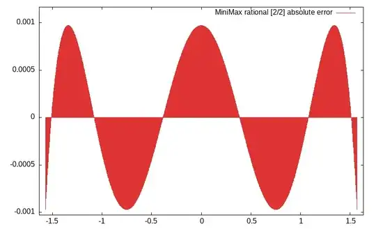

That way, we get the symmetry of $\cos$ and $f$ can be approximated by a rational function $g$ of degree [1/1]. Doing the numerics (Remez algorithm), one finds
g(x) = \frac{p(x)}{q(x)} = \frac{9.8473383 - 3.9958133 x}{9.8377958 + x} \tag 3
where the function is normalized so that coefficient $q_1=1$. The coefficients of the numerator and denominator polynomial only loosely resemble the values of $\cos \approx(\pi^2-4x^2)/(\pi^2+x^2)$ worked out in the other answer.
The absolte error is given by
$$ \max_{x\in[0,\pi^2/4]} |g(x)-f(x)| = \max_{|x|\leqslant \pi/2} |g(x^2)-\cos(x)| < 0.00097 \tag 4$$
which is an accuracy of around 3 decimals or almost exactly 10 bits.
Plot: Absolute error of $g(x^2)$ against $\cos(x)$ for $|x|\leqslant\pi/2$.
The optimality of $g(x)$ (or of $g(x^2)$ for that matter) follows from the alternant property of the absolute error: If $\Delta=\max|g-f|$ the absolute error oscillates between $+\Delta$ and $-\Delta$ which is nicely demonstrated by the plot above.

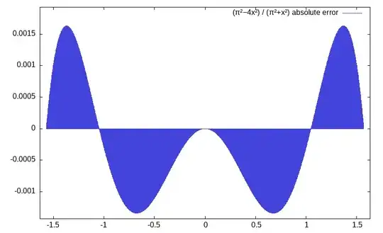

In contrast, the non-optimality of the classic
$$ \frac{\pi^2-4x^2}{\pi^2+x^2} \tag 5$$
is immediately clear from the plot below because the absolue error does not oscillate nicely with constant "amplitude".
Plot: Absolute error of $(π²−4x²)/(π²+x²)$ against $\cos(x)$ for $|x|\leqslant\pi/2$.
Conclusion
The classic $(\pi^2-4x^2)/(\pi^2+x^2)$ has an absolute error of ca. $1.63\cdot 10^{-3}$, whereas the optimal $$ g(x^2) = \frac{9.8473383 - 3.9958133 x^2}{9.8377958 + x^2} \tag6 $$ has an absolute error of less than $10^{-3}$.

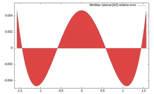

For optimizing the relative error, the situation is similar: The classic formula is sub-optimal, and we can numerically approch the best possible rational function of degree [2/2].
As $\cos$ has zeros at $\pm\pi/2$, we have to divide them out so that the relative error is well-behaved. Using Remez, we find:
\frac{\cos x}{(\frac\pi2-x)(\frac\pi2+x)} \approx r(x)=\frac{3.676844}{9.030178 + x^2} \tag7
with a relative error of $0.0047$ over the target interval as shown by the following plot.
Hence, the best approximation in terms of relative error amongst all rational functions of degree [2/2] or less is:
r(x)\left(\frac{\pi^2}4-x^2\right) = \frac{3.676844}{9.030178 + x^2}\left(\frac{\pi^2}4-x^2\right) \tag8

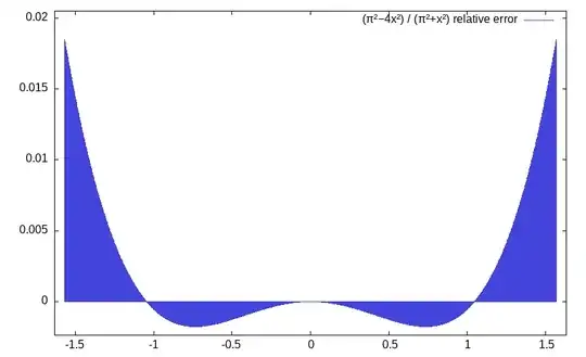

The relative error of the classic approximaton is around $0.019$, which is 4 times the relative error of $(8)$.
Desmos plot of approximations and their relative errors
