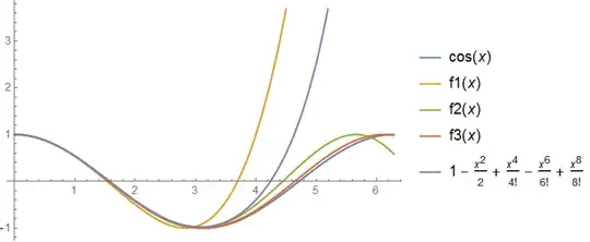

For the angles in the range $0<x<\frac{\pi}{2}$ Taylor expansion of the same order fits better. On the other hand, for larger angles this method is superior, as you can see from the graphs.
cos(x), f1, f2, f3
