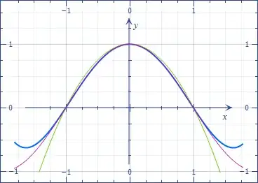

Convert the argument to a multiple of $\pi/2\approx1.57$, i.e. express the angle in "quadrants". It is an easy matter to reduce to the first quadrant.
Then
$$\cos x^*\approx 1-x^2$$ is a resonable approximation ($<5\%$ maximum error, green curve).
You can get better with an extra term,
$$\cos x^*\approx(1-x^2)\left(1-\frac{\pi^2-8}8x^2\right)\approx(1-x^2)\left(1-\frac7{30}x^2\right).$$
($<0.3\%$, blue curve.)
The sine is obtained from $\sin x^*=\cos(1-x^*)$ and the tangent from the ratio. The arc sine/cosine can be drawn form the first approximation, but require a square root extraction, which is uneasy.
