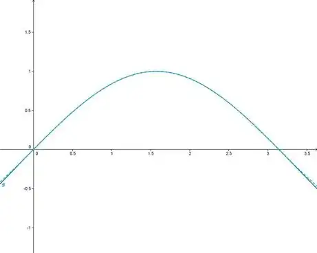

Here's an image. Cyan for the sine and blue for the approximation. enter image description here
¿Is there any way of proving such rational approximation? ¿Is there any theory similar to Taylor's or Power Series for rational approximations?

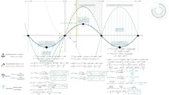

That's a pretty neat visualization of how can you intiutively build, proove and understand the approximation. enter image description here
The full proof with video and explanation.
