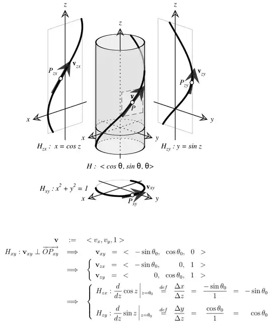

Perhaps the following diagram will provide insight:
(Non)Proof without Words: Derivatives of Sine and Cosine
The idea is to look at the sine and cosine curves as projections of a helix drawn on a cylinder. If you look at the cylinder itself as a curled planar square of length $2\pi$, then helix is a curled version of the square's diagonal. A tangent vector along the flat square's diagonal always lies at 45 degrees to the square's sides, say with length-"1" shadows in each direction; after smoothly curling the square into the cylinder, the tangent vector lies at 45 degrees to the cylinder's ($z$-)axis and the perpendicular ($xy$-)plane.
Projecting the helix into the $zy$- and $zx$-planes gives graphs of sine and cosine. Projecting the helix's tangent vector gives tangent vectors to those graphs. The "$\mathrm dz$"s for these projected tangents are always $1$ (the "vertical" shadow of the helix's tangent vector). To get at "$\mathrm dy$" and "$\mathrm dx$" ("$v_x$" and "$v_y$" in the diagram) we project down into the $xy$-plane where we see a circle, and yet another projected tangent vector.
Basic geometry tells us that a tangent to a circle is perpendicular to the radius at the point of tangency. In our circle, the point of tangency --and the radius vector it-- is parameterized as "$<\cos$, $\sin$, $0>$". The perpendicular tangent line must therefore have a "negative-reciprocal" direction vector: "$<-\sin$, $\cos$, $0>$", which gives us our "$\mathrm dx$" and "$\mathrm dy$" for the helix tangent ... and the projected graph tangents as well, so that we may make the following conclusions:
The derivative of cosine --by its conceptual definition as "slope of the tangent line"-- is change-in- $x$-over-change-in-$z$ = $\mathrm dx/\mathrm dz = -\sin/1 = -\sin$.
Likewise, the derivative of sine is $\mathrm dy/\mathrm dz = \cos/1 = \cos$.
I like this approach because the conceptual "slope of tangent line" definition of the derivative is used throughout; there are no (obvious) appeals to digressive computational tricks involving trig identities and limits of difference quotients. I also like that the curious negative sign in the derivative of cosine traces back to an elementary property of circle geometry.
Of course, this approach doesn't constitute proof of the formulas. The process of curling the planar square into a cylinder and claiming that the tangent vector behaves as claimed actually assumes the computational machinery covered by the traditional limit arguments. Nevertheless, on an intuitive level, I think this argument explains the "why" of the derivatives quite beautifully. Then, knowing what the formulas are (or "should be") helps motivate the investigation of the computational tricks needed to provide a rigorous proof.
Here's a PDF with a variant of the above discussion (but the same image). Here's a Mathematica Demonstration that animates the various elements, including the square curling into the cylinder.

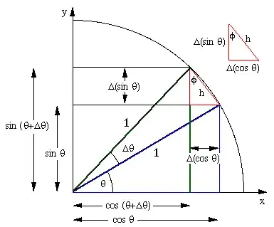

I agree with David (+1), this is the pertinent graph, and it works for me:
Sin and cosine on the unit circle
From here.
Updated (added brief explanation to make this self-contained):
The main right triangle (in blue) gives $\cos \theta$ (horizontal side) and $\sin \theta$ (vertical). The small change $\Delta \theta$ produces a new triangle with the corresponding $\cos(\theta +\Delta \theta )$ and $\sin(\theta +\Delta \theta)$
Now, looking at the small triangle (in red) we see that its legs correspond to the increments $\Delta(\sin \theta)$ and $-\Delta(\cos \theta)$ ; furthermore, for small increments, the hypotenuse $h$ tends to the arc $\Delta \theta$, and the small triangle is similar to the main one (hence $\phi \to \theta$).
But $\cos \phi=\Delta(\sin \theta)/h \to d(\sin \theta)/ d\theta $. Hence $d(\sin \theta)=\cos \theta \, d\theta$
Doing the same for the other leg, we get $d(\cos \theta)= - \sin \theta \, d\theta$
leonbloy
  • 63,430
    In detail: $\frac{d(\sin\theta)}{d\theta}=\frac{r(O_2-O_1)}{L}=\frac{rL\cos\phi}{L}=\cos\phi=\cos\theta$ where $r$ is the radius, $O$ is the opposite, $L$ is the small hypoteneuse, $d\theta=\frac{L}{r}$ and $\phi=90°-(90°-\theta)=\theta$. Any approximations become true as $d\theta\rightarrow0$. –  Jun 01 '17 at 01:16

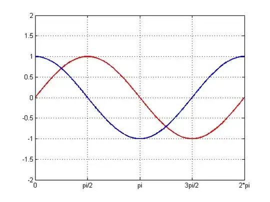

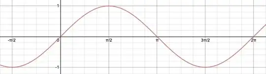

Let's talk about the first one,
$$\frac{d}{dx}\sin(x) = \cos(x)$$
Take a look at the plot:
$\sin$ is red, $\cos$ is blue.
The rate of change of the red curve ($\sin$) is exactly the current y-value of the blue curve ($\cos$) at every point.
Pointing out some salient points:
  • @ x=$\frac{\pi}{2}$, $\sin(\frac{\pi}{2})=1$ and $\cos(\frac{\pi}{2})=0$. This means the rate of the sin curve @ x=$\frac{\pi}{2}$is NOTHING, which you can see clearly in the graph - a local maximum.
  • @ x=0, $\sin(0)=0$ and $\cos(0)=1$, which means sin(x) should appear to travel along the straight line y=x at the origin, which it does. In fact, near x=0 we have the approximation sin(x)=x.
  • @ x=$\frac{\pi}{2}^+$, you can see $\sin(\frac{\pi}{2}^+)$ starts to go downward. At this point, $\cos(\frac{\pi}{2}^+)$ ALSO dips below the x-axis, i.e. for the first time the rate of change of sin(x) becomes negative.

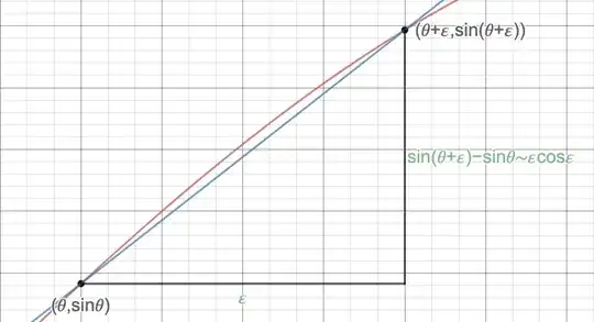

    I don't think that looking at the plot is enough to confirm the numerical exactness of the rate of change of the red curve and the rate of change of the blue curve. It might show that they're somewhat correlated, but that they have exact numerical equivalence at every point in time is not something you can get from looking at a plot like that, I think. – Justin L. Oct 20 '15 at 22:03
From first principles,using trig identities and small-angle approximations:
$$\sin'(x) = \lim\limits_{ h\to 0}\frac{\sin(x+h)-\sin(x)}{h}$$
$$\sin(x+h) = \sin(x)\cos(h)+\cos(x)\sin(h)$$
$$\Rightarrow \sin'(x) = \lim\limits_{ h\to 0}\frac{(\sin(x)(\cos(h)-1) + \cos(x)\sin(h))}{h}$$
For $x$ small, $\sin(x)\sim x$, so $$\lim\limits_{ h\to 0}\frac{\sin h}{h}=1$$and $$\cos(x)\sim 1 -\frac {x^2} 2 $$ so $$\lim\limits_{ h\to 0}\frac{\cos h-1}{h}=0$$
$$ \sin'(x) = \cos(x)$$
