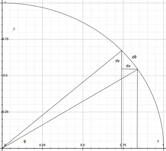

Now here comes the claim. The average value, with respect to $\theta$, of the height of the line segment times the circumference of the quarter of the circle is the area of a unit square. enter image description here
Let $h$ denote the average value, with respect to $\theta$, of the height of the line segment i.e. $$\displaystyle h = \frac{\int_{0}^{\pi/2} y d \theta}{\int_{0}^{\pi/2} d \theta}$$
The claim is
$$\displaystyle h \times \frac{\pi}{2} = 1$$
Proof:
First note that the area of the square with vertices at $(0,0),(0,1),(1,0),(1,1)$ is obviously $1$.
$\displaystyle \text{Area of square} = 1 = \int_{0}^{1} 1 \times dx = \int_{0}^{1} dx$.
For points on the circle, $\displaystyle x^2 + y^2 = 1 \Rightarrow xdx + ydy = 0 \Rightarrow dy = -\frac{x}{y} dx$.
Further, for the small triangle, we have
$$\displaystyle (dx)^2 + (dy)^2 = (1 \times d \theta)^2$$ $$\displaystyle (dx)^2 + \frac{x^2}{y^2}(dx)^2 = (d \theta)^2$$ $$\displaystyle \frac{x^2 + y^2}{y^2}(dx)^2 = (d \theta)^2$$ $$\displaystyle (dx)^2 = y^2 (d \theta)^2$$
Note that as $\theta$ increases from $0$ to $\frac{\pi}{2}$, $x$ decreases from $1$ to $0$ and hence
$$\displaystyle dx = -y d \theta$$
Hence, $$\displaystyle \text{Area of square} = 1 = \int_{0}^{1} 1 \times dx = \int_{0}^{1} dx = \int_{\pi/2}^0 (-y) d \theta = \int_0^{\pi/2} y d \theta$$
Hence, $\displaystyle 1 = \int_0^{\pi/2} y d \theta = \frac{\int_0^{\pi/2} y d \theta}{\int_0^{\pi/2} d \theta} \times \int_0^{\pi/2} d \theta$
Note that $\displaystyle \int_0^{\pi/2} d \theta = \frac{\pi}{2}$ which is the circumference of the quadrant and $\displaystyle h = \frac{\int_0^{\pi/2} y d \theta}{\int_0^{\pi/2} d \theta}$ is the average value, with respect to $\theta$, of the height of the line segment.
Hence, we get $\displaystyle h \times \frac{\pi}{2} = 1$ i.e. average value, with respect to $\theta$, of the height of the line segment if $\frac{2}{\pi}$.
Hence, we get that $$\displaystyle \int_{0}^{\pi/2} \sin(\theta) d \theta = 1$$ when $\theta$ is in radians

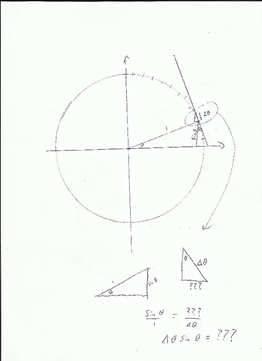

This answer is similar to the answer of Marvis, but I think that it is conceptually a bit cleaner.
The $\sin(\theta)$ is defined as the y-coordinate of the point on the unit circle obtained by starting at the origin and moving a distance of $\theta$ along the unit circle in the counterclockwise direction.
So lets investigate what $\displaystyle \int_0^{\pi/2}\sin(\theta)$ would look like geometrically.
We are taking the interval $[0,\frac{\pi}{2}]$ and partitioning it into a million tiny pieces. On the unit circle, we have just broken the quarter circle in the first quadrant up into a million pieces. Then we need to multiply the lengths of each of these little segments by the height of the left endpoint of that line segment, and sum all of these values together. We need a geometric understanding of what that product looks like, i.e. how can we interpret $\sin(\theta)\Delta\theta$ geometrically?
Since we are looking at such a short segment of the circle, $\Delta\theta$ looks a lot a segment of the tangent line to the circle at that point. By geometry, the tangent line to the circle is perpendicular to the radius, and so the small triangle in the picture is similar to the large one. This lets us show that $\sin(\theta)\Delta\theta$ is approximately the small horizontal change in the picture (this is in fact a small change in cosine(\theta)).
Thus we are really just accumulating small horizontal distances. The total horizontal distance that you move from $\theta = 0$ to $\theta =\frac{\pi}{2}$ is 1, and so that is the integral.
