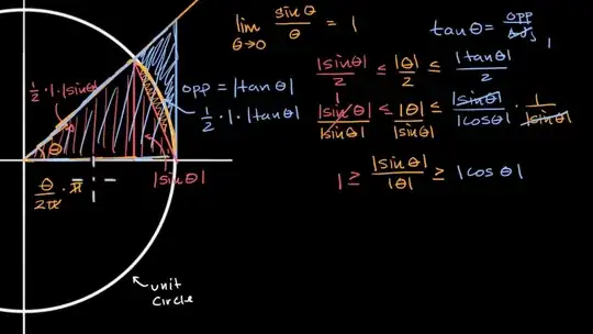

There is a very nice Khan Academy video on it. I won't get into too much detail but basically you construct the following enter image description here
Then you take limits of the inequality $$1\geq|\frac{\sin\theta}{\theta}|\geq|\cos\theta|$$
to get $$\lim_{\theta->0}1\geq|\frac{\sin\theta}{\theta}|\geq|\cos\theta|$$ $$1\geq|\frac{\sin\theta}{\theta}|\geq|1$$
and and therefore by the squeeze theorem we have $\lim_{\theta->0}\frac{\sin\theta}{\theta}=1$.
