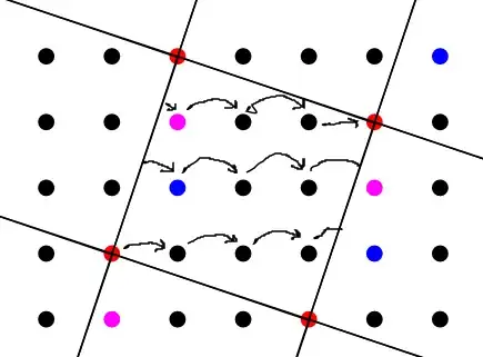

100
Gaussian integers modulo $3-i$
This diagram shows the Gaussian integers modulo $3-i$.
The red points shown are all considered to be $0$ but their locations in $\mathbb Z[i]$ are $0$, $3-i$, $i(3-i)$ and $3-i + i(3-i)$. Every congruence class must be inside that box once and you can see there are $10$ of them.
The arrows show adding by $1$ each time. Doing that takes you through every equivalence class and then back to the start.
So $\mathbb{Z}[i]/(3-i) \cong \mathbb{Z}/10\mathbb{Z}$.
