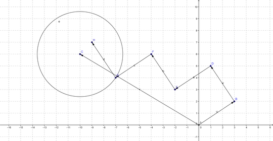

Think about this problem geometrically:
For example : $\alpha=3+2i$ and $\beta=-10+6i$
Consider a circle of radius $\sqrt{3^2+2^2}$ by centered at $\beta$, and then move from $\alpha$ to $\beta$ !
$$\beta=\overrightarrow{AB}+\overrightarrow{BD}+\overrightarrow{DE}+\overrightarrow{Ef}+\overrightarrow{FG}+\overrightarrow{GH}+(-1-i) =$$ $$\alpha+i\alpha-\alpha+i\alpha-\alpha+i\alpha+(-1-i)=$$ $$(-1+3i)(3+2i)+(-1-i)$$
It's easy to generalize this idea to get a complete proof.
And by this way it's easy to see why $q$ and $r$ in $\beta = q\alpha+r$ are not necessarily unique. Because you can move form $\alpha$ into the circle around the $\beta$, by different ways!
