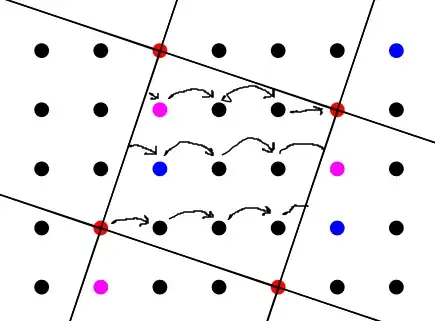

If you look at the picture enter image description here
taken from the answer Quotient ring of Gaussian integers by quanta in the above-mentioned thread, you see that we want to count the lattice points in the square spanned by $a+bi$ and $-b+ai$.
As the points on the border have to be partially identified, it turns out we want to count interior points plus half the border points -1. (Since opposite sides of the square are identified, we want to count only half the border points, but we want to count only 1 of the 4 corners, so we have to subtract one.)
This gives exactly the area $\left(\sqrt{a^2+b^2}\right)^2=a^2+b^2$ of the square by Pick's theorem.

    @yunone: I agree that Pick's theorem (or Euclid's algorithm, or perhaps the argument by user10676) is best here. I was just chiming in that this answer is wrong. What I was suggesting is the following: If $gcd(a,b)=d$, then we can first draw the trivial conclusion that the ideal $I$ generated by $a+bi$ is an index $d^2$ subgroup in the ideal $J$ generated by $(a/d)+(b/d)i$. Then $gcd(a/d,b/d)=1$, and the arguments based on $a,b$ being coprime shows that ideal $J$ is of index $(a/d)^2+(b/d)^2$ in the ring $\mathbf{Z}[i]$. Putting these two pieces together gives the desired conclusion again. – Jyrki Lahtonen Oct 30 '11 at 09:46
  • @Jyrki Thanks for that!, and for confirming that the answer isn't wholly correct. I notice you mention Euclid's algorithm, but how does it follow so easily from that? For say $\mathbb{Z}/m\mathbb{Z}$, it's clear this has size $m$ since there are only $m$ possible remainders modulo $m$. How does it work analogously in $\mathbb{Z}[i]$? After dividing some $x+yi$ by $a+bi$, I should get a remainder with norm less than $a^2+b^2$, but how would I know there are $a^2+b^2$ possible remainders? – yunone Oct 30 '11 at 09:56
  • @yunone: Probably the best way to see that is to look at the figure in Phira's answer. The length of the diagonal of the square is $d=\sqrt{2(a^2+b^2)}$. And you also see that any point on the plane (in particular any point on the grid) is at a distance at most $d/2$ from one of the corners (=red dots). So if you need to "divide" a gaussian integer $w=u+iv$ by $a+bi$, then you locate the red dot closest to $w$. That is of the form $q(a+bi)$ for some gaussian integer $q$. Let $r$ be the separation vector. Then you have $w=q(a+bi)+r$, and $|r|\le d/2=\sqrt{(a^2+b^2)/2}$. – Jyrki Lahtonen Oct 30 '11 at 10:12
