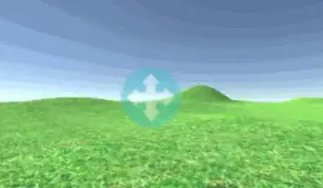

Let's say we're making a first-person camera. The basic idea is it should yaw to look left & right, and pitch to look up & down. So we write a bit of code like this (using Unity as an example):
void Update() {
    float speed = lookSpeed * Time.deltaTime;
    // Yaw around the y axis using the player's horizontal input.
    transform.Rotate(0f, Input.GetAxis("Horizontal") * speed, 0f);
    // Pitch around the x axis using the player's vertical input.
    transform.Rotate(-Input.GetAxis("Vertical") * speed,  0f, 0f);
or maybe
// Construct a quaternion or a matrix representing incremental camera rotation.
Quaternion rotation = Quaternion.Euler(
                         0);
// Fold this change into the camera's current rotation.
transform.rotation *= rotation;
And it mostly works, but over time the view starts to get crooked. The camera seems to be turning on its roll axis (z) even though we only told it to rotate on the x and y!
Animated example of a first-person camera tilting sideways

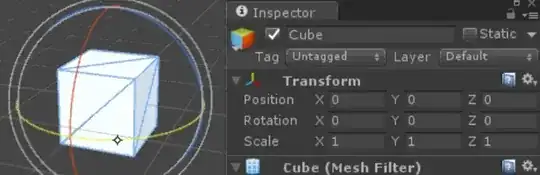

In many engines you'll also see this in the inspector - rotate the object in the world, and suddenly numbers change on an axis we didn't even touch!
Animated example showing manipulating an object next to a readout of its rotation angles. The z angle changes even though the user didn't manipulate that axis.

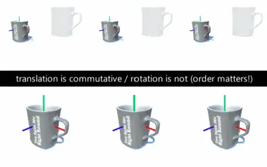

You've discovered a real fact about how rotation works in three-dimensional space, and it departs from our intuition about other transformations like translation:
Animated example showing that applying rotations in a different order gives different results
When we compose rotations on more than one axis, the result we get isn't just the total/net value we applied to each axis (as we might expect for translation). The order in which we apply the rotations changes the result, as each rotation moves the axes on which the next rotations get applied (if rotating about the object's local axes), or the relationship between the object and the axis (if rotating about the world's axes).
The changing of axis relationships over time can confuse our intuition about what each axis is "supposed" to do. In particular, certain combinations of yaw and pitch rotations give the same result as a roll rotation!
Animated example showing a sequence of local pitch-yaw-pitch gives the same output as a single local roll
You can verify that each step is rotating correctly about the axis we requested - there's no engine glitch or artifact in our notation interfering with or second-guessing our input - the spherical (or hyperspherical / quaternion) nature of rotation just means our transformations "wrap around" onto each other. They may be orthogonal locally, for small rotations, but as they pile up we find they're not globally orthogonal.
This is most dramatic and clear for 90-degree turns like those above, but the wandering axes creep in over many small rotations too, as demonstrated in the question.
