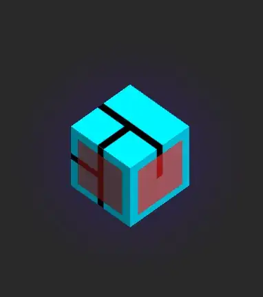

So I'm trying to build a simple mechanic where the player see's 3 sides of a cube at a time: top, left and front(I called the front-side "Right" in my code, due to the orthographic view). The player can click on the front side or left side of the cube to rotate the cube so that the side that was pressed moves and becomes the top face. I want to smooth/animate the rotation.Cube Example
The red faces are the faces that the user can click on.
My Logic seems to work quite well when I click on the left face (Rotating along the x axis), but doesn't seem to work well for the front/right face(It usually works once and then does weird stuff on the next click, this is on the z-axis)

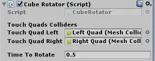

Inspector Values:
Inspector Values
I've tried several things, the only problem I can think of is, gimbal lock. Thanks in advance.
