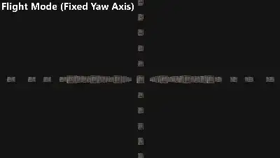

  • Flight (Fixed Yaw Axis)
    • enter image description here
    • Regardless of where the camera is looking, yaw is rotated along the global y axis. This was based on the linked post that 'DMGregory' wrote. As you can see from the gif, this has the effect of 'stabilizing' the horizon. Pitch is clamped at +/- 85 degrees. Flight movement controls are based on local camera coordinates. For example, when I use vertical up movement, this uses the cameras local up axis, not the global y axis. In order to get this axis, I simply take the cross product of the camera_forward vector with the camera_right vector. I can also see how a user may want vertical up/down to be tied to the world up/down, and will probably make that an option (i.e. setting the vertical movement axis as the world_up).

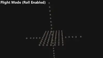

  • Flight (Roll Enabled)
    • Roll Mode
    • For flight mode without a fixed yaw axis, everything is based on local camera coordinates. Yaw is being replaced by roll in this mode and is not used at all. Roll is done along the cameras forward vector. This gives a fairly natural feel for how you would control a spaceship. This also has the added benefit of not running into any gimbal lock, so there is full rotation along any axis. The movement vertical up/down controls are based on the local camera_up vector. As a side note, yaw could also be included in this mode (along the local cameras up vector). However, for my camera system I added a toggle between modes. When the user is in fixed yaw mode, left and right on the mouse result in yaw changes. When the user enters flight without fixed yaw, roll is used based on left and right mouse movement. Yaw could be added in and tied to a key if desired.
