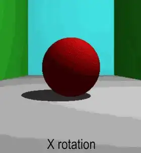

I'm programming a C raytracer. I'm having trouble getting the camera to rotate the way I intend.
I would like the camera to rotate by pressing keys:
  • F & H rotate left & right around the world's vertical axis (Y)
  • T & G rotate up & down around an axis that is always horizontal and perpendicular to the view axis.
  • R & Y rotate around the camera's viewing axis (local Z)
But with my current code, rotating up and then left rotates on a diagonal, instead of going around the world Y axis:
How can I make this rotation control more intuitive?

I tried this :
void    make_rotation_x(t_vec3 *rot_x, float angle)
    float   c;
    float   s;
c = cos(angle);
s = sin(angle);
rot_x[0] = (t_vec3){1, 0, 0};
rot_x[1] = (t_vec3){0, c, -s};
rot_x[2] = (t_vec3){0, s, c};
void make_rotation_y(t_vec3 *rot_y, float angle) { float c; float s;
