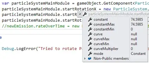

The rotation.eulerAngles.x/y/z values are coming through correctly, and by debugging in VS I can see that the values have been correctly assigned, as below:
Correctly assigning rotation.eulerAngles.x with the value of the rotation provided in the Quaternion parameter
However I observe that the particle system is not at all orientated with this X value, and the particle system is showing a completely different value:
Completely incorrect value observed in the editor and orientation of particle system
You can see from the screenshots above that a value of 74.5f becomes 4274.2f by the time it hits the particle system.
I have double checked that the type expected by the ParticleSystem.MinMaxCurve constructor is a float. I cannot understand why this is happening.

When in doubt, don't forget to read the docs:
public ParticleSystem.MinMaxCurve startRotationX;
The initial rotation of particles around the X axis when emitted.
Note that the value should be given in radians
So 74.5 radians converted to degrees for display in the editor is:
74.5 • 180° / π = 4268.5°
Which looks on par with what you're seeing in the inspector.
Dropping the scale of all your code-provided angles to a few multiples of π should make things behave much more sensibly.
Also remember that order matters when composing rotations, like the x, y, and z angles in Euler form, so take this into account when planning the angles you use to avoid surprises.
