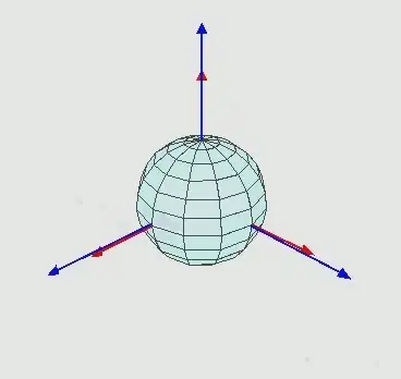

I'm want to control the direction my camera looks, so I'm using Euler angles, so rotating around an axis is relative to rotation around previous axis. Something like this.
Euler Angles
I want to always rotate using the blue axes. So I'm using three separate matrices to track rotation along their respective axes.

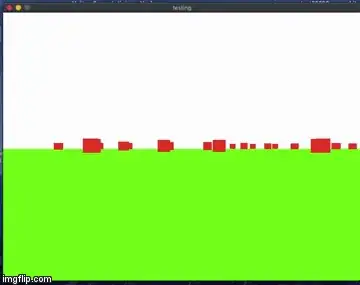

I get the desired output (rotate around x axis then y)
working

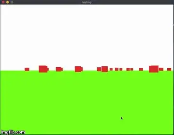

But when I switch the order of multiplication, I get different output (rotate around y then x axis)
glm::mat4 lookat = glm::lookAt(
                    camPos,
                    mulVec(a1.xAxis * a1.yAxis, target),
                    mulVec(a1.xAxis * a1.yAxis, camup)
not working
So whats happening here. I'm assuming the order should not matter.
