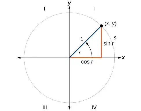

This is a bit of an artifact of the yaw convention they've chosen to use. OpenGL examples I've found seem to base this off of a version of Euler/Tait-Byran angles, where yaw is measured as the angle between forward and the positive x-axis:
Diagram showing measurement of yaw in the article linked above.
This threw me for a loop at first too - I'm used to 0 yaw meaning we have applied zero rotation about the vertical axis (Unity uses this convention), but these articles take 0 yaw to mean "facing along the positive x axis."
Once we adapt to this slightly-turned way of looking at things, the formulas make sense again. When yaw is zero or ±π, our camera is looking along the x-axis, and so naturally pitching up or down should foreshorten the x component of the forward vector.

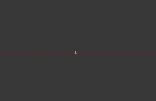

Yaw is applied first, then pitch, you can see this on the following gif (I first rotate the pitch, then I do the same but I change the yaw too): enter image description here
