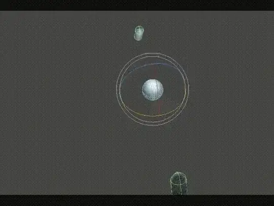

Fun with quaternion dot products - Spherical worlds and orbitals
Simulations of entire planets and even entire solar systems are getting increasingly common. In order to pull this off in realtime, we need the quaternion dot product too. Lots of them. The quaternion dot product is very underused but it certainly has its uses - Let's take a look!
Firstly, we have a whole series of rotations to consider:
  1. (Optionally) The star around the galactic centre
  2. The planet around the star
  3. The tilt of the planet
  4. The spin of the planet
  5. The position of nearby grid cells (rotated about the planets core)*
  6. Multiple orbital planes
Combine them all together and you end up with a lot of complexity (and a lot of huge numbers!). When the viewer is standing on the surface of the planet, we don't want them to be hurtling at some crazy speed through our gameworld space. We'd actually rather they were stationary and somewhere near the origin - move the universe around the player instead.
Rotating planet
Importantly, in order for us to be able to get the planet's spin and tilt correct in this scenario, we need to axis lock the pole so it can only swing up/down on the image above (i.e. swinging "up" as the player travels north). That's where a quaternion dot product comes in. If we didn't use a dot product here and instead just multiplied the tilt too, this would happen:
Incorrectly tilted 'planets'
Notice how the poles of our orbiting 'planets' are always tilting towards the star. This isn't what happens in reality - the tilt is in a fixed direction.
Without going too far off topic, here's a quick summary:
  • On a sphere, an orientation also neatly describes a surface position.
  • We've got lots of rotations to combine together.
  • Describe everything as rotation; the position of the viewer, too. This helps boost performance as ultimately we end up doing less operations.
  • The angle between rotations (our dot product) then helps measure longitude and works particularly well at dealing with tilts.
By obtaining only the angle, we drop some of that unwanted rotation. At the same time we also ended up with a longitude measurement which is useful for navigation as well as the local climate.
* Planets are constructed from lots of grid cells. Only the nearby ones actually get displayed.

    This does a great job setting the scene and motivating the problem, but I'm still a bit fuzzy on how the math of the quaternion dot product (ie. the scalar product dot(a, b) = a.x*b.x + a.y*b.y + a.z*b.z + a.w*b.w as opposed to quaternion composition which we'd use to chain-together rotations) would help us solve this problem. I'd gladly upvote if you're able to elaborate on this a little later (I don't mean to keep you from your slerp...I mean sleep!) – DMGregory Nov 22 '16 at 03:55
  • @DmGregory the short answer is tilt is the odd one out; everything composes nicely except for that one (the planet would appear to wobble around its star otherwise). I'll (hopefully!) add some more context tomorrow! – Luke Briggs Nov 22 '16 at 04:05
  • @DMGregory I've added some additional information (I couldn't sleep!) - hopefully that makes it clearer. – Luke Briggs Nov 22 '16 at 04:36
    Sorry if I'm being a bit dense, but after re-reading several times I still don't know how I'd use the dot product in a formula to achieve the transformation you're describing. Would you be able to add a little pseudocode laying out the operations you perform explicitly? – DMGregory Nov 22 '16 at 16:07
  • @DMGregory I'm not familiar with the quaternions but if this is rotations on a sphere, then this isn't rotation compositions. This is using spherical geometry with vectors to compute the normal vector for a "line" on the surface of a sphere AKA any circumference. Once again, the answer makes little sense nor does this question, but I believe they are using spherical geometry. – user64742 Nov 23 '16 at 05:27
  • @TheGreatDuck We use both, but not for what this answer is describing. In short, quaternions are great for rotation and orbiting planets involve a lot of rotations - this answer addresses a use case for the quaternion dot product; it's very rarely used as it's, broadly speaking, used to find the angle between orientations. – Luke Briggs Nov 23 '16 at 08:14
  • @DMGregory Hmm, it's really the kind of thing that would be best described in a blog/ video (and I lack both the time and liberty for that one unfortunately!). The above is a heavy simplification; we're actually combining over 10 different rotations and it's proving challenging to describe it without the full context (which itself would be way out of scope of the question). I'll pull together a summary which should hopefully clear it up. – Luke Briggs Nov 23 '16 at 08:27
