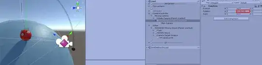

I want to acheive the same rotation you see in the inspector. In short: a smooth local Y rotation, toward a target
I have a Vector3 orientation: Vector3 dirOrientation = targetToLook.position - movingCamera.position;
So, every Update, what should I do ? I try many thing, but I don't realy understand Quaternion...
I just want to rotate localy in Y, toward a precise moving target, NOT in X or Z. and smoothly with some Lerp or Slerp.
Thanks !
