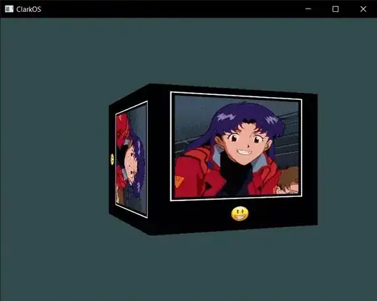

This replaces the whole Matrix thing I was going with and actually makes the camera work like I wanted. Thanks again to DMGregory for just being cool.
Result(idk why the colors are freaking out it wasn't actually doing that it's just recording artifact i guess):
