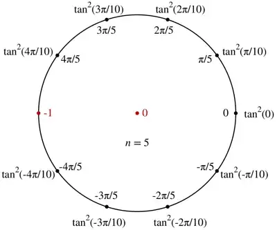

This problem is over 3 years old, but I was just made aware of it, so I thought I would add a new method of attack, similar to this answer.
Here we use the function $\dfrac{2n/z}{z^{2n}-1}$ which has residue $1$ at each $2n^\text{th}$ root of unity and residue $-2n$ at $0$.
Since $\tan^2\left(\dfrac\theta2\right)=-\left(\dfrac{z-1}{z+1}\right)^2$ for $z=e^{i\theta}$, define $$ f(z)=-\left(\frac{z-1}{z+1}\right)^2\frac{2n/z}{z^{2n}-1} $$ The sum of the residues of $f$ is $0$ since $|f(z)|\sim2n/z^{2n+1}$ as $|z|\to\infty$ and so an integral around a large circle vanishes.
On the other hand, the sum of the residues is twice the sum we want plus the residue at $0$ and the residue at $-1$.
$\hspace{32mm}$
Thus, $$ \begin{align} \sum_{k=1}^{n-1}\tan^2\left(\frac{k\pi}{2n}\right) &=-\frac12\left(\operatorname*{Res}_{z=0}(f(z))+\operatorname*{Res}_{z=-1}(f(z))\right)\\ &=-\frac12\left(2n-\frac23(2n^2+1)\right)\\ &=\frac{2n^2-3n+1}{3} \end{align} $$
