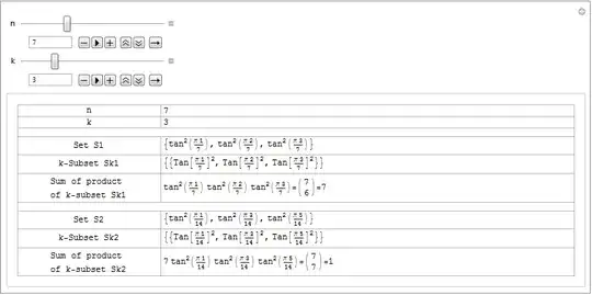

Here are some examples with n=7 and k varying from 1 to 3. We have: $S=\left\{\tan ^2\left(\frac{\pi 1}{7}\right),\tan ^2\left(\frac{\pi 2}{7}\right),\tan ^2\left(\frac{\pi 3}{7}\right)\right\}$
  1. for k=1, k-subset is $S_1=\left\{ \left\{\tan ^2\left(\frac{\pi 1}{7}\right)\right\},\left\{\tan ^2\left(\frac{\pi 2}{7}\right)\right\},\left\{\tan ^2\left(\frac{\pi 3}{7}\right)\right\} \right\}$, so $\tan ^2\left(\frac{\pi 1}{7}\right)+\tan ^2\left(\frac{\pi 2}{7}\right)+\tan ^2\left(\frac{\pi 3}{7}\right)=\left( \begin{array}{c} 7 \\ 2 \end{array} \right)=21$
  2. for k=2, k-subset is $S_2=\left\{ \left\{\tan ^2\left(\frac{\pi 1}{7}\right),\tan ^2\left(\frac{\pi 2}{7}\right)\right\},\left\{\tan ^2\left(\frac{\pi 2}{7}\right),t\tan ^2\left(\frac{\pi 3}{7}\right)\right\},\left\{\tan ^2\left(\frac{\pi 1}{7}\right),t\tan ^2\left(\frac{\pi 3}{7}\right)\right\} \right\}$, so $\tan ^2\left(\frac{\pi 1}{7}\right) \tan ^2\left(\frac{\pi 2}{7}\right)+\tan ^2\left(\frac{\pi 3}{7}\right) \tan ^2\left(\frac{\pi 2}{7}\right)+\tan ^2\left(\frac{\pi 1}{7}\right) \tan ^2\left(\frac{\pi 3}{7}\right)=\left( \begin{array}{c} 7 \\ 4 \end{array} \right)=35$
  3. for k=3, k-subset is $S_3=\left\{ \left\{\tan ^2\left(\frac{\pi 1}{7}\right),\tan ^2\left(\frac{\pi 2}{7}\right),\tan ^2\left(\frac{\pi 3}{7}\right)\right\} \right\}$, so $\tan ^2\left(\frac{\pi 1}{7}\right) \tan ^2\left(\frac{\pi 2}{7}\right) \tan ^2\left(\frac{\pi 3}{7}\right)=\left( \begin{array}{c} 7 \\ 6 \end{array} \right)=7$
Tan binomial formulaes 1 Tan binomial formulaes 2 Tan binomial formulaes 3
Here is the Mathematica code corresponding to the images, if someone wants to play around:
Manipulate[
Module[
set1,S1,Sk1,psk1,pskEven1,
set2,S2,Sk2,psk2,pskEven2,
ProdSumSubset,binEven,bin1,bin2,
hf,rh,opt1
hf[x_]:=HoldForm@x;
rh[x_]:=ReleaseHold@x;
set1[n_]:=Table[ Tan[hf@( k)*Pi/hf@(n) ]^2,{k,1,Floor@((n-1)/2)}] ;
set2[n_]:=Table[ Tan[hf@(2 k-1)*Pi/hf@(2*n) ]^2,{k,1,Floor@(n/2)}] ;
ProdSumSubset[S_,k_]:=Plus@@(Times@@#&/@ Subsets[S,{k}]);
bin1[n_,k_]:=Binomial[n,hf@(2*k)];
bin2[n_,k_]:=Binomial[n,hf@(2*k+1)];
opt1={ Frame->All,Alignment->{{Center,Left},Center},ItemSize->{{[email protected],[email protected]}},FrameStyle->GrayLevel[0.7`] };
TraditionalForm@
Grid[
{ "n",n },
{ "k",k },
{"",SpanFromLeft},
{ "Set S1",S1=set1[n] },
{ "k-Subset Sk1",Sk1=Subsets[S1,{k}]//StandardForm },
psk1=ProdSumSubset[S1,k];
pskEven1=If[ EvenQ@n,n*psk1,psk1 ];
binEven=If[ EvenQ@n,bin2[n,k],bin1[n,k] ];
{ "Sum of product of k-subset Sk1",Row[{ pskEven1,"=", pskEven1//rh//N,"=",binEven,"=",binEven//rh}] },
{"",SpanFromLeft},
{ "Set S2",S2=set2[n] },
{ "k-Subset Sk2",Sk2=Subsets[S2,{k}]//StandardForm },
psk2=ProdSumSubset[S2,k];
pskEven2=If[ EvenQ@n,psk2,n*psk2 ];
binEven=If[ EvenQ@n,bin1[n,k],bin2[n,k] ];
{ "Sum of product of k-subset Sk2",Row[{ pskEven2,"=", pskEven2//rh//N,"=",binEven,"=",binEven//rh}] }
},opt1
,{{n,7},1,20,1,Appearance->"Open"}
,{{k,1},1,10,1,Appearance->"Open"}
