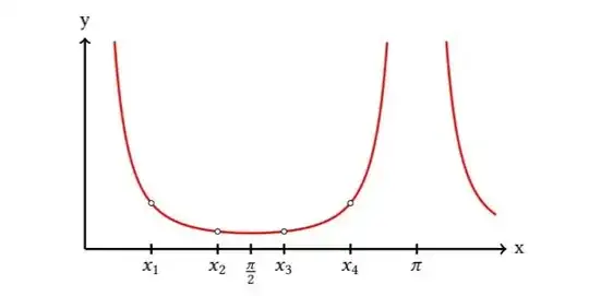

$ \frac{1}{\sin^2 x_1} + \frac{1}{\sin^2 x_2} + \ldots + \frac{1}{\sin^2 x_m} = \frac{2m^2 + 2m}{3} $
As a consequence of $\frac{1}{\sin x}$'s symmetries, the sum of the $k = m + 1$, $2m$ terms has the same value as the sum of the $k = 1$, $\ldots$, $m$ terms.
We've established that
$ \frac{1}{\sin^2 x_1} + \ldots + \frac{1}{\sin^2 x_{2m}} = \frac{1}{\sin^2 \left(\frac{\pi n}{n}\right)} + \ldots + \frac{1}{\sin^2 \left(\frac{\pi (n - 1)}{n}\right)} = \sum_{k=1}^{n-1} \frac{1}{\sin^2 \left(\frac{\pi k}{n}\right)} = \frac{2(2m^2 + 2m)}{3} = \frac{(2m + 1)(2m + 1) - 1}{3} = \frac{n^2 - 1}{3}. $
This completes the proof for the case of odd values of $n$
