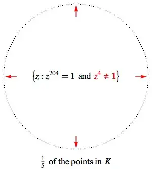

In a question recently deleted by its author, it was asked that given $$ K=\{z:z^{1020}=1\text{ and }z^4\ne1\} $$ what is $$ \sum_{z\in K}\frac{1+z}{1-z+z^2-z^3} $$ It seemed that this question might benefit from the method used in this answer, this answer, or this answer, even though this question did not involve trigonometric functions as did the questions for those answers.
