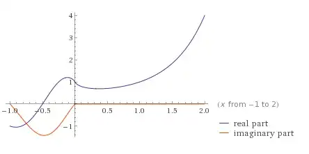

There are so many fantastic answers already, but no pictures which is sad. $0^0$ is undefined - is it the limited case of $x^0$, $0^x$ or $x^x$? The plots for $x^0$ (a line at 1) and $0^x$ (a line at zero) are boring, but $x^x$ is
$x^x$
Author/Site: Wolfram|Alpha
Publisher: Wolfram Alpha LLC
URL: https://www.wolframalpha.com/input/?i=plot+x%5Ex
Retrieval date: 6/2/2015
