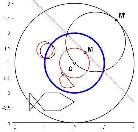

Inversion transform with center (or pole) $C$ and power $k^2$ is defined by:
$$\tag{1}J_{C,k}:M \leftrightarrow M' \ \ \ \ \ \iff \ \ \ \ \ \ \ \vec{CM'}=\frac{k^2}{||\vec{CM}||^2} \ \vec{CM} $$
It is an "involutive" transform: $M'$ is the image of $M$ iff $M$ is the image of $M'$. This explains the double arrow.
This transform, credited to Magnus and more or less at the same time to Plücker in the early 1830s, is detailed in many books/sites.
See Appendix 1 for a comment about inversion properties displayed on Fig. 1.
Fig. 1. : Inversion with center $C$ and power 1. Shapes in black are exchanged by inversion with shapes in red. The blue circle, called "circle of inversion", is the locus of invariant points.

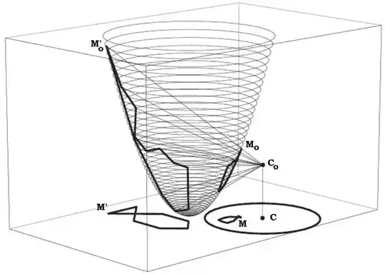

  1. "Champagne glass inversion" : Fig. 2 shows how inversion with center $C$ and radius of inversion $k$ (we find back the large and the small fish, inverted images one of the other...) can be realized by a 3 steps $P\Gamma P^{-1}$ operation with respect to a paraboloid $\Pi$, where:
  • $P$ is the vertical projection from $\Pi$ onto the horizontal plane, and
  • $\Gamma$ is the conical projection from $\Pi$ to $\Pi$ with center $C_0(a,b,a^2+b^2-k^2)$ where $(a,b)$ are the coordinates of $C$.
This non-classical way to describe inversion deserves an explanation that we have placed in Appendix 2.
Fig. 2. Inversion by a conical projection $\Pi \to \Pi$.

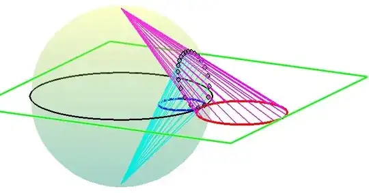

  1. "Bubble inversion" This is a cousin representation of the first one with a sphere instead of a parabola (see Fig. 3). It necessitates to use 2 steps with the two stereographic projections $S_N$ and $S_S$ from the North and South pole resp. with respect to the equatorial plane. Take a look at Fig. 3.
Consider a certain figure, say the circle in red. It is transformed by $S_N$ into the circle on the unit sphere materialized by black little diamonds ; this circle is transformed in turn by $S_S$ into the blue circle on the equatorial plane... which is the inversive image of the initial red circle. Briefly said :
$$\tag{$\star$}I=S_S \circ S_N$$
This shouldn't come as a surprise because stereographic projections are themselves 3D inversions.
See (composition of stereographic projections is inversion through the ball - a geometric way) for a proof.
Fig. 3. (planar) inversion realized by combining two stereographic projections (formula ($\star$)).

Appendix 1: Recall of properties of inversion as depicted by Fig. 1:
  • The image of a straight line is in general a circle passing through the pole $C$ ; exceptionally, when the straight line passes through the origin, its image is the line itself (caution: in the latter case, the straight line is "globally" invariant, but its points, in general, aren't invariant).
  • The image $\Gamma'$ of a circle $\Gamma$ not passing through the origin is a circle of the same type (caution: the center of $\Gamma'$ is not the image of the center of $\Gamma$ ; nevertheless these centers are aligned with the pole of inversion). The image of a circle passing through the origin is a straight line, as said before.
  • The image of the black fish made of line segments is the red fish made of circular arcs swimming in its blue round fishbowl.
Appendix 2: Explanation of inversion depicted in Fig. 2.
Let us begin by another definition of inversion.
$$\tag{3}J_{C,k}:M \to M' \ \ \ \ \iff \ \ \ \ \ \exists \vec{U} \ \text{(unit norm vector) s.t.} \ \begin{cases}\vec{CM}=\lambda \vec{U}\\ \vec{CM'}=\lambda' \vec{U}\end{cases} \ \text{and} \ \lambda\lambda'=k^2$$
Let $M(x,y)$ and $M'(x',y')$ exchanged by inversion $J_{C,k}$.
Let $M_0(x,y,x^2+y^2)$ and $M_0'(x',y',x'^2+y'^2)$ be their "lifted version" on paraboloid $\Pi$.
Let $N(X,Y,Z) $ be any point of line $C_0M_0$. We can define an abscissa $\mu$ on this line for point $N$ in the following way:
$$\tag{$\star$}\vec{C_0N}=\mu \vec{C_0M_0} \ \ \ \ \iff \ \ \ \ \begin{cases}X=a+\mu(x-a)\\ Y=b+\mu(y-b)\\ Z=c+\mu(x^2+y^2-c)\end{cases}$$
with $$c:=a^2+b^2-k^2.$$
Please note that for $\mu=1$, $N$ is in $M_0$. Let $\lambda'$ be the value of $\mu$ associated with $M'_0$.
Thus $N \in \Pi$ in two cases: when $\mu=1$ ($N=M_0$) and when $\mu=\lambda'$ ($N=M'_0$). As
$$\tag{3}N \in \Pi \ \iff \ Z=X^2+Y^2,$$
plugging in (3) the expressions of $X,Y,Z$ in $(\star)$, and replacing $c$ by its defining expression, we obtain the following quadratic equation with unknown $\mu$:
$$\mu^2[(x-a)^2+(y-b)^2] \ + \ \mu[\cdots] \ + \ k^2=0$$
Using the classical formula for the roots' product, we have
$$\lambda' \times 1 =\dfrac{k^2}{(x-a)^2+(y-b)^2}=\dfrac{k^2}{\|\vec{CM}\|^2}$$
We find back here the definition of inversion given in (2) (recall that $\vec{CM}$ hasn't been normalized).

In your question you discuss inversion via two quadrics, i.e. the paraboloid and the sphere.
The book Pedoe, Geometry: A Comprehensive Course has an excellent description of this phenomenon. The cases of paraboloid and sphere are essentially the same, tied together by a projective transformation. I'll refer the reader, if interested, to the book for the details (pg 151-152).
The illustration above is taken from the book. The essential idea is that we are using stereoscopic projection for a paraboloid $\Pi$ instead of a sphere. The projection point corresponding to the north pole $N$ of the sphere is the point at infinity in the direction of the $Z$ axis. The circle is lifted to an ellipse that is a planar section of $\Pi$, and the point $P$ is the pole of that plane with respect to $\Pi$.
The point $A$ is lifted to a point $Q$ on $\Pi$. The line $PQ$ intersects $\Pi$ in a second point $Q'$, which projects down to $A'$, the inverse of $A$.
This is simply a rewrite of the champagne glass inversion in the question, but translates it into a more projective form - incidence, projection, poles, polars. It can be translated word for word to work for the sphere $\Sigma$ and arbitrary circles, not just the equatorial circle.
One immediate application of this approach is to find the point $O'$ on the sphere $\Sigma$ that projects to the center $O$ of a circle. Since we know that $O$ inverts wrt the circle to the point at infinity, we can conclude that $O'$ is the intersection of the line $NP$ and $\Sigma$. And from that we can conclude that the line $NP$ passes through $O$.

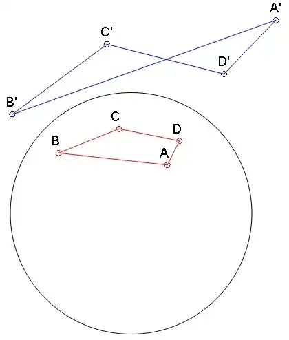

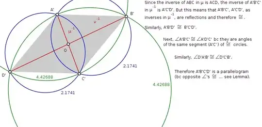

Any four distinct points A, B, C, D can be inverted into the vertices of a parallelogram $A'B'C'D'$ (including, as one possibility, a degenerate parallelogram in which the four vertices lie on one line, but still $A'B' = D'C'$ and $A'D' = B'C'$). Hint: Consider separately the three cases (i) $AC // BD$; (ii) $AB // CD$ or $AD // BC$; (iii) A, B, C, D not concyclic.
Note: the // notation refers to point-pair separation. One way of characterizing is that AC // BD when every circle through A and C intersects every circle through B and D.

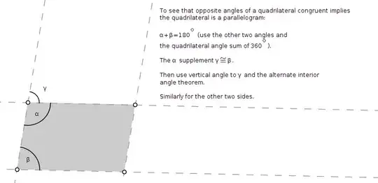

Finally I actually asked a question Is this usage of the term 'Jacobian' related to the other uses e.g. matrix or elliptic function? related to this (where this is repeated) that I never had anyone answer!
The diagrams below give my rendition of the book (Geometry Revisited) solution for the (iii) case.
Exercise 5.7.6
5.7.6 supplementary
5.7.6 Lemma
