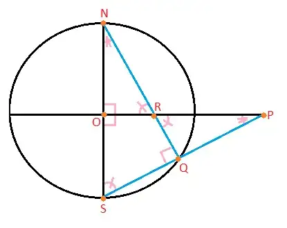

The points, its projections and the poles all reside in some 2D cross section of space, so it suffices to do the problem in 2D. I assume you're working with the unit circle.
Let's draw a picture and label some points. Say $N$ is the north pole, $S$ is the south pole, $O$ is the origin, $Q$ is a point on the unit circle (without loss of generality in quadrant IV), with stereographic projections given by $\pi_S(Q)=P$ and $\pi_N(Q)=R$.
$\hskip 1in$ stereographic projection
We will show the triangles $\triangle NOR$ and $\triangle POS$ are similar by showing they have the same angle measures (in order). Similarity implies an equality of ratios $[PO:OS]=[NO:OR]$. Since both of the line segments $NO$ and $OS$ are length $1$, this proves $PO$ and $OR$ are reciprocal lengths.
By the "angle inscribed in semicircle" theorem, $\angle NQS$ is a right angle. Clearly $\angle NOR$ is also a right angle. Note that the angles $\angle NRO$ and $\angle PRQ$ are equal, and complementary to $\angle ONR$ and $\angle OPS$ which are in turn complementary to $\angle NSP$.
