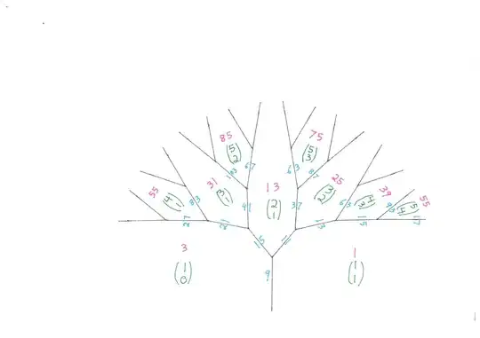

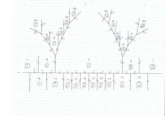

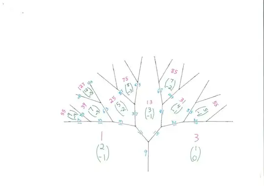

EEDDIITT: unfortunate, you missed two infinite strings. I carefully drew Conway's topograph for one cycle. The four solutions with small entries, in distinct orbits, are $(4,1), (5,-1),(5,4), (9,-4).$
The four strings, continued in both directions, become $$ \ldots (32972,-17497);(1321,-701);(53,-28); (4,1); (47,53) ; (1171,1324); (29228,33047); \ldots $$ $$ \ldots (62275,-33047);(2495,-1324);(100,-53);(5,-1); (25,28) ; (620,701); (15475,17497); \ldots $$ $$ \ldots (15475,-8212);(620,-329);(25,-13);(5,4); (100,113) ; (2495,2821); (62275,70412); \ldots $$ $$ \ldots (132687,-70412);(5316,-2821);(213,-113);(9,-4); (12,13) ; (291,329); (7263,8212); \ldots $$
I decided to make a very careful tree outline so that I could fill in the relevant bits of the Conway topograph and have it clearly visible. In brief, one diagram shows behavior along the "river." However, specific representations of a number with larger absolute value happen a bit away from the river, in trees... I have carefully shown how the four representations of $55$ with small entries, arise in the diagram.
Here is a jpeg of the relevant portion of Conway's topograph for this problem. This is from The First Lecture in The Sensual Quadratic Form. Note that the 2 by 2 matrix
$$ A \; = \; \left( \begin{array}{rr} 8 & 15 \\ 9 & 17 \end{array} \right) $$ is visible towards the right of the diagram, the value $3$ with coordinate vector $$ \left( \begin{array}{r} 8 \\ 9 \end{array} \right), $$ and on the lower right of that we find the value $-5$ with coordinate vector $$ \left( \begin{array}{r} 15 \\ 17 \end{array} \right). $$ That 2 by two matrix, which is where I got the formula $ (8x+15y,9x+17y), $ is the generator of the automorphism group of the quadratic form, also called the orthogonal group, the rotation group, etc. The traditional name for it was "automorph," not so many use that any more except me, i guess. The automorph also comes, quickly, from the Lagrange cycle method, illustrated in the computer output below that. The best book for that is Duncan A. Buell, Binary Quadratic Forms.

    @janmarqz thanks. I edited in my list of answers either talking about the diagrams or having drawings. The answer above gives fairly good examples of two tree parts of the diagram, it is actually the "river" that is less predictable and may need more than one try to fit on a page. – Will Jagy Jan 03 '16 at 04:34
