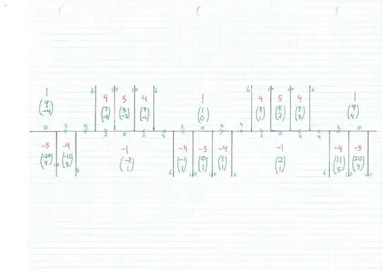

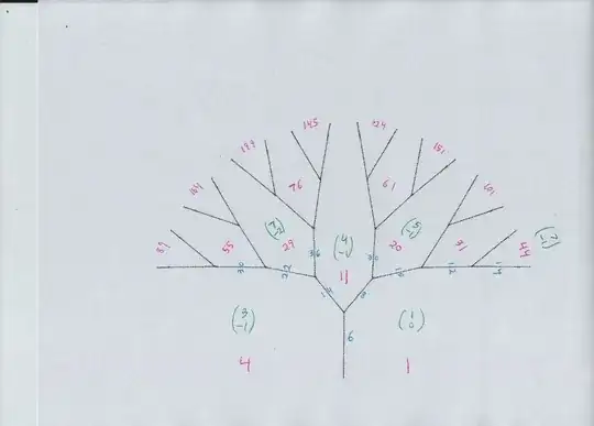

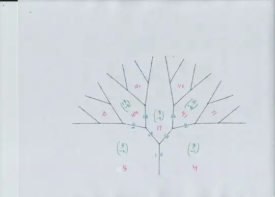

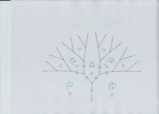

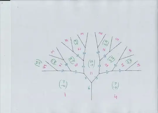

A way to be sure that all solutions have been found in a Pell type problem is Conway's topograph diagram. The way I draw it now is one main diagram of the "river," then one or more trees growing off the river. The conclusion is that all solutions to $$ u^2 - 5 v^2 = 44 $$ come from tree locations (green vectors) $$(32,-14), (43,-19),(17,-7),(13,-5),(16,-4),(8,-2). $$ Note that $(32, -14)$ is simply double $(16,-7),$ because the latter is a representation of $11.$ Same with $(8,-2).$
For your problem you need to negate any possible pair, at least negate the first coordinate $u,$ because you have $u = 5y+7.$ For example, $u=7$ is a useful solution for you, but $u=-7$ is not. Together, a dozen "seed" pairs $$ ( -43, 19), ( -32, 14), ( -17, 7), ( -13, 5), ( -8, 2), ( -7, 1), ( 7, -1), ( 8, -2), ( 13, -5), ( 17, -7), ( 32, -14), ( 43, -19). $$
together with the rules for transforming solutions (below) give everything needed. What becomes clear from looking at the river diagram is that. Or, you can stick with the half dozen original seeds, in $u$ order $$( 43, -19), ( 32, -14), ( 17, -7), ( 13, -5), ( 8, -2), ( 7, -1), $$ find all transformed pairs, and every time you get a new $(u,v)$ also consider $(-u,v).$ That is what I would do...
Given solution $(u,v)$ to $u^2 - 5 v^2 = 44,$ we get new solutions going to the right or to the left in the Conway diagram by transforming to either $$ (u,v) \mapsto (9 u + 20 v, 4 u + 9 v ) $$ or $$ (u,v) \mapsto (9 u - 20 v, -4 u + 9 v ) $$ There are therefore infinitely many solutions, but these are all.

And these are the diagrams, river and trees i called A,B,C,D...
enter image description here enter image description here enter image description here enter image description here enter image description here
