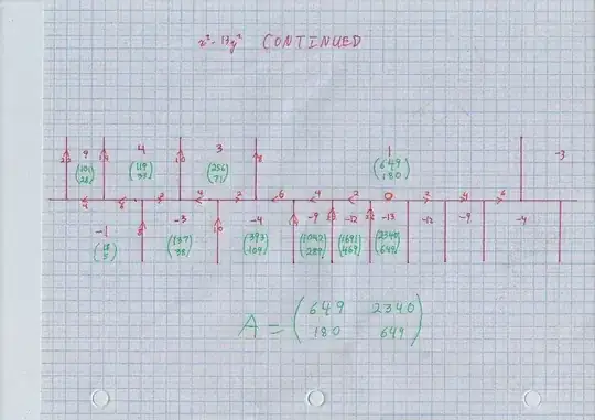

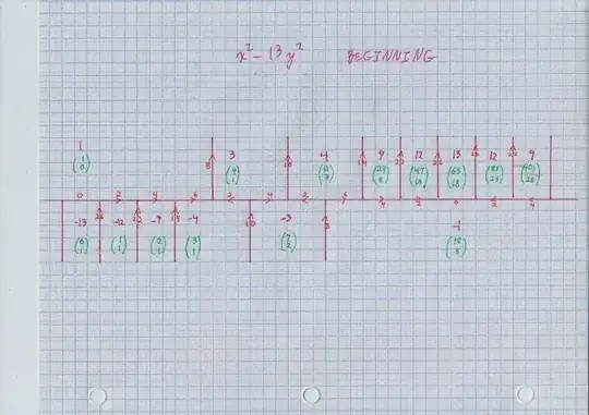

The "topograph" for $x^2 - 13 y^2$ is definitely more complicated than the previous ones, because the continued fraction for $\sqrt {13}$ has period 5, your two previous examples had period 1. Confirming the "automorph" matrix, which just preserves the quadratic form:
gp-pari
? form = [ 1,0; 0,-13]
%1 =
[1 0]
[0 -13]
? a = [649, 2340; 180, 649]
%2 =
[649 2340]
[180 649]
? atranspose = mattranspose(a)
%3 =
[649 180]
[2340 649]
?  atranspose  * form * a
%5 =
[1 0]
[0 -13]
The pairs of numbers in green are vectors in the plane. Two basic properties. First, each shows its value for $x^2 - 13 y^2.$ For example, in the first occurrence of 4, we see the (column) vector $(11,3),$ and we can easily confirm that $11^2 - 13 \cdot 3^2 = 4. $ Next, around any point where three purple line segments meet (even if two are parallel), one of the three green vectors is the sum of the other two. For example, $$ (4,1) + (7,2) = (11,3). $$ As long as we just continue to the right, we can continue getting all positive entries in green.

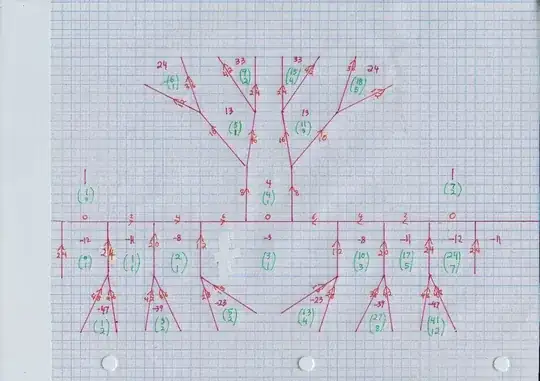

    @Stefan4024, I posted a new answer for $x^2 - 12 y^2$ including the target value 13. In general, we need to draw in extra layers away from the river. See The Climbing Lemma in Conway, book page 11, and the diagram with extra layers on book page 22. Of course, the diagram gets a little cramped for space. – Will Jagy Mar 29 '13 at 19:43
Stefan, you generally need to add more layers away from the river, and that is the case for $x^2 - 12 y^2$ and the target number 13. In this expanded diagram, you see how moving away from the river increases the absolute value of the purple numbers. However, none possessing a primitive representation ($\gcd(x,y)=1$) is missed. Here the two starting vectors for 13 are $(5,1)$ and $(11,3).$

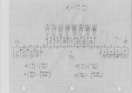

Same method, less color. The automorph $A$ is at the top, as $$ A = \left( \begin{array}{cc} 33 & 136 \\ 8 & 33 \end{array} \right). $$
You can check: $$ \left( \begin{array}{cc} 33 & 8 \\ 136 & 33 \end{array} \right) \left( \begin{array}{cc} 1 & 0 \\ 0 & -17 \end{array} \right) \left( \begin{array}{cc} 33 & 136 \\ 8 & 33 \end{array} \right) = \left( \begin{array}{cc} 1 & 0 \\ 0 & -17 \end{array} \right). $$

  • @Stefan4024, you made a good start. I posted one full cycle for $x^2 - 13 y^2$ as a separate answer just now. I am pleased that awllower has gotten involved. If you email me, using whatever fake email name you wish, and a working email address that hides your identity as much as you want, I can forward that to awllower, as I already have his email address. – Will Jagy Mar 28 '13 at 20:50
