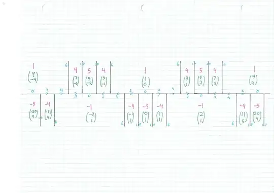

I also put four related excerpts, all with the prefix indefinite_binary, at OTHER. Dmitry says the computer zakuski is being decommissioned, hope it continues to work through late January. I especially like Stillwell's presentation. Put it all together, for a Pell form, indeed any form $a x^2 + b xy + c y^2$ with $a > 0, \; b \geq 0, \; c < 0,$ but $b^2 - 4ac$ not a perfect square, we get a diagram that shows all of Conway's information, along with the $(x,y)$ pairs as column vectors, with an explicit illustration of the (proper) automorphism group generator, that being the mapping $(x,y) \mapsto (9x+20y,4x+9 y). $
Did not notice this one ten days ago. There is an explicit structure for representing a number by an indefinite quadratic form. This is chapter one in Conway's The Sensual Quadratic Form. I wrote a little program recently, and no longer make simple arithmetic mistakes in these.
It turns out that all occurrences of $\pm 4$ happen along the "river" for $x^2 - 5 y^2. $
Given any solution to $x^2 - 5 y^2 = \pm 4,$ we gat the same value by switching $(x,y)$ to $$ (9x+20y,4x+9 y). $$ The two by two matrix causing this transformation (on column vectors) is $$ A \; = \; \left( \begin{array}{rr} 9 & 20 \\ 4 & 9 \end{array} \right) , $$ which you can see towards the right of the diagram as the coordinates of the final $1$ and then the final $-5,$ placed side by side. The big theorem is that the entire diagram is periodic. I find the finite set of representatives within one cycle, apply the transformation I wrote arbitrarily many times, and i get all. As there is no $xy$ term in $x^2 - 5 y^2,$ there is a simple $\pm$ symmetry as well.

There is plenty more that could be said; anyway, these give all solutions. Oh, the other business, the "climbing lemma," says that values only increase (in absolute value) when leaving the river. The next layers of values are $\pm 11$ at the continuation of each edge with a light blue $6,$ and $\pm 19$ at the continuation of each edge with a light blue $10.$ So we have done enough to catch all $\pm 4$ already.
