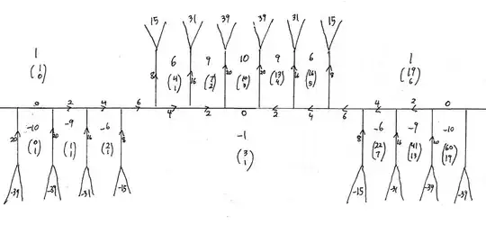

It appears you are not satisfied with Gerry's website solver.
It is true that the continued fraction method gives all (primitive) solutions to $ x^2 - n y^2 = m,$ as long as $m < \sqrt n.$ This is a theorem of Lagrange.
So, when you take $9 = 3^2$ and find all solutions to $x^2 - 10 y^2 = 1$ by the continued fraction for $\sqrt {10},$ you do get all non-primitive solutions for $9$ by multiplying by $\pm 3.$
Now, $9 > \sqrt{10}.$ So the best you can do, which is fairly intricate but elementary, is Conway's topograph method, chapter 1 in CONWAY which can be bought at BUY_ME. The part you need to work with is pages 18-23, sections "Indefinite forms not representing $0$: The river" and "Integer-valued forms have periodic rivers." I really do not want to attempt to describe the method here. Please buy the book. If you do that, and email me, I can make a diagram giving enough detail of the "topograph" for $x^2 - 10 y^2,$ scan that somewhere as a pdf, and send you that. Conway does not actually give any fully worked out example. The fortunate thing for this problem is that the value $9$ occurs only along the river itself...see the Climbing Lemma, pages 11 and 20.
Meanwhile, once you have a column vector with entries $x,y$ that solves $x^2 - 10 y^2 = 9,$ another solution can be had by multiplying the column vector by the "automorph" $$ A \; = \; \left( \begin{array}{cc} 19 & 60 \\ 6 & 19 \end{array} \right) $$
or its inverse $$ A^{-1} \; = \; \left( \begin{array}{cc} 19 & -60 \\ -6 & 19 \end{array} \right). $$ For example $$ \left( \begin{array}{cc} 19 & 60 \\ 6 & 19 \end{array} \right) \left( \begin{array}{c} 7 \\ 2 \end{array} \right) = \left( \begin{array}{c} 253 \\ 80 \end{array} \right) $$ and, indeed, $253^2 - 10 \cdot 80^2 = 9.$ $$ \left( \begin{array}{cc} 19 & 60 \\ 6 & 19 \end{array} \right) \left( \begin{array}{c} 7 \\ -2 \end{array} \right) = \left( \begin{array}{c} 13 \\ 4 \end{array} \right) $$ and , indeed, $13^2 - 10 \cdot 4^2 = 9.$ Then $$ \left( \begin{array}{cc} 19 & 60 \\ 6 & 19 \end{array} \right) \left( \begin{array}{c} 13 \\ -4 \end{array} \right) = \left( \begin{array}{c} 7 \\ 2 \end{array} \right) $$ and $$ \left( \begin{array}{cc} 19 & 60 \\ 6 & 19 \end{array} \right) \left( \begin{array}{c} 13 \\ 4 \end{array} \right) = \left( \begin{array}{c} 487 \\ 154 \end{array} \right) $$ while $487^2 - 10 \cdot 154^2 = 9.$
See also RIVER.
Full cycle: Conway's method has some little tweaks compared to Lagrange/Gauss/Eisenstein. I think what I will do, since I do not know how to post the diagram [now added below], is just to put all the equivalent forms along the "river," always taking the first component positive (disagrees with Gauss) and always taking the equivalence matrix to have positive determinant. With these conventions, it is necessary to take some of the forms with negative middle coefficient. It's a lifestyle choice. I try not to judge.
 Will Drawing
So, when I say $\langle 1, 0, -10 \rangle $ is equivalent to $\langle 9, 2, -1 \rangle $ with matrix $A \in SL_2 \mathbf Z$ given by $$ A \; = \; \left( \begin{array}{cc} 7 & 3 \\ 2 & 1 \end{array} \right), $$ this means that $A$ is on the right and $$ \left( \begin{array}{cc} 7 & 2 \\ 3 & 1 \end{array} \right) \left( \begin{array}{cc} 1 & 0 \\ 0 & -10 \end{array} \right) \left( \begin{array}{cc} 7 & 3 \\ 2 & 1 \end{array} \right) = \left( \begin{array}{cc} 9 & 1 \\ 1 & -1 \end{array} \right). $$ When I say $\langle 1, 0, -10 \rangle $ is equivalent to $\langle 9, -2, -1 \rangle $ with matrix $A \in SL_2 \mathbf Z$ given by $$ A \; = \; \left( \begin{array}{cc} 13 & 3 \\ 4 & 1 \end{array} \right), $$ this means that $A$ is on the right and $$ \left( \begin{array}{cc} 13 & 4 \\ 3 & 1 \end{array} \right) \left( \begin{array}{cc} 1 & 0 \\ 0 & -10 \end{array} \right) \left( \begin{array}{cc} 13 & 3 \\ 4 & 1 \end{array} \right) = \left( \begin{array}{cc} 9 & -1 \\ -1 & -1 \end{array} \right). $$
With those in mind, a full cycle along Conway's river is $$\langle 1, 0, -10 \rangle, \left( \begin{array}{cc} 1 & 0 \\ 0 & 1 \end{array} \right), $$

Various items, already mentioned. The first "automorph" is then $$ \left( \begin{array}{cc} 19 & 60 \\ 6 & 19 \end{array} \right). $$ The forms with negative middle coefficient are precisely those edges that point to the left. We switch from altering the first column to altering the second column, or back, precisely at the "reduced" forms, which in this case are only $\langle 1, 6, -1 \rangle$ and $\langle -1, 6, 1 \rangle,$ where we have written the latter as $\langle 1, -6, -1 \rangle$ to stick with beginning with a positive coefficient. Finally, there was no need to stray away from the river for this problem, $9$ is just small enough to spare us that extra complication.
