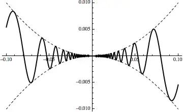

The basic example of a differentiable function with discontinuous derivative is $$ f(x) = \begin{cases} x^2 \sin(1/x) &\mbox{if } x \neq 0 \\ 0 & \mbox{if } x=0. \end{cases} $$ The differentiation rules show that this function is differentiable away from the origin and the difference quotient can be used to show that it is differentiable at the origin with value $f'(0)=0$. A graph is illuminating as well as it shows how $\pm x^2$ forms an envelope for the function forcing differentiablity.

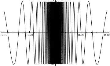

The derivative of $f$ is $$ f'(x) = \begin{cases} 2 x \sin \left(\frac{1}{x}\right)-\cos \left(\frac{1}{x}\right)&\mbox{if } x \neq 0 \\ 0 & \mbox{if } x=0, \end{cases} $$ which is discontinuous at $x=0$. Its graph looks something like so

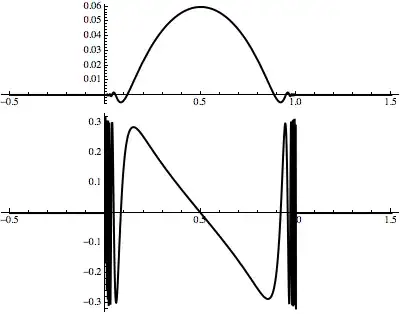

The next step is to modify this example to obtain a function that is everywhere differentiable with a derivative that is continuous on all of $\mathbb R$, except for two points. To this end, consider $$ f(x) = \begin{cases} x^2 (1-x)^2 \sin \left(\frac{1}{\pi x (1-x)}\right)&\mbox{if } 0<x<1 \\ 0 & \mbox{else}. \end{cases} $$ The graph of $f$ and its derivative look like so.
