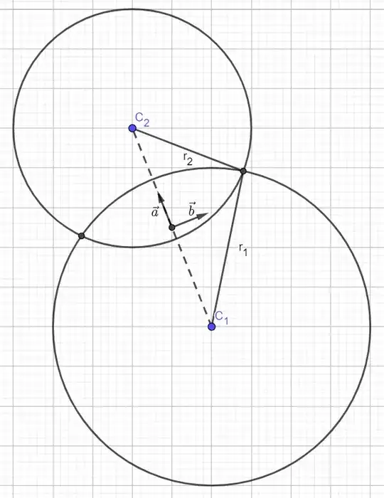

Easy solution is to consider another plane such that the centers are along an axis.
Given the points $(x_1,y_1)$ and $(x_2,y_2)$. We focus on the center point of both circles given by $$ \left( \frac{x_1+x_2}{2}, \frac{y_1+y_2}{2} \right). $$
The distance between the centers of the circles is given by $$ R = \sqrt{ (x_2-x_1)^2 + (y_2-y_1)^2}. $$
We can consider the following orthogonal vectors $$ \vec{a} = \left( \frac{x_2-x_1}{R}, \frac{y_2-y_1}{R} \right), \vec{b} = \left( \frac{y_2-y_1}{R}, - \frac{x_2-x_1}{R} \right). $$
a b coordinate plane
In the $(\vec{a},\vec{b})$ plane we get the equations $$ \big( a + R / 2 \big)^2 + b^2 = r_1^2,\\ \big( a - R / 2 \big)^2 + b^2 = r_2^2. $$
Whence $$ a = \frac{r_1^2 - r_2^2}{2R},\\ b = \pm \sqrt{ \frac{r_1^2+r_2^2}{2} - \frac{(r_1^2-r_2^2)^2}{4R^2} - \frac{R^2}{4}}. $$ The intersection points are given by $$ (x,y) = \frac{1}{2} \big( x_1+x_2, y_1+y_2 \big) + \frac{r_1^2 - r_2^2}{2R^2} \big( x_2-x_1, y_2-y_1 \big)\\ \pm \frac{1}{2} \sqrt{ 2 \frac{r_1^2+r_2^2}{R^2} - \frac{(r_1^2-r_2^2)^2}{R^4} - 1} \big( y_2-y_1, x_1-x_2 \big), $$ where $R$ is the distance between the centers of the circles.

    It would be helpful to include a geogebra sketch of this solution. I have trouble visualizing it also. – John Alexiou Aug 21 '16 at 21:20

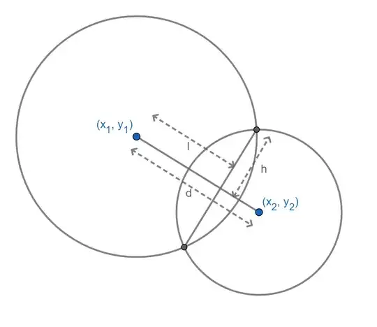

A nice way to look at this is to first consider the case when the center of one circle is at the origin and the center of other lies on the x-axis. Let the centers be at $(0,0)$, $(d,0)$ and the radii be $r_1$, $r_2$. The two equations simplify to $$x^2+y^2=r_1^2$$ and $$(x-d)^2+y^2=r_2^2$$ Use the first to find $y^2$ and substitute in the second. $$(x-d)^2+r_1^2-x^2=r_2^2$$ expand and simplify $$-2xd+d^2+r_1^2=r_2^2$$ so the points of intersections are $(x,y), (x,-y)$ with $$x=\frac{r_1^2-r_2^2+d^2}{2d}$$ and from Pythagorus $$y=\sqrt{r_1^2-x^2}.$$ This part came from mathworld.
For the general position case with centers $(x_1,y_1)$ $(x_2,y_2)$. Let $$\begin{align} d&=\sqrt{(x_1-x_2)^2+(y_1-y_2)^2}\\ l&=\frac{r_1^2-r_2^2+d^2}{2d}\\ h&=\sqrt{r_1^2-l^2} \end{align}$$ General position Now $\left(\tfrac{x_2-x_1}{d},\tfrac{y_2-y_1}{d}\right)$ $\left(\tfrac{y_2-y_1}{d},-\tfrac{x_2-x_1}{d}\right)$ are two orthogonal unit vectors and we can rotate and translate to get the general solution $$\begin{align} x&=\frac{l}{d}(x_2-x_1) \pm \frac{h}{d}(y_2-y_1) + x_1,\\ y&=\frac{l}{d}(y_2-y_1) \mp \frac{h}{d}(x_2-x_1) + y_1.\\ \end{align}$$
    I like this solution a lot, due to its geometric meaning. The interpretation is clear once a diagram is made. I suggest either a diagram or some text such as the following should be included: – TimeVariant Feb 23 '24 at 21:32
    1. Change "... one point is at the origin and the other lies on the x-axis." to "one circle is centered at the origin and the other on the x-axis."
    2. The two points of intersection have the same x-value. [This for the first case.]
    3. Here l and h are the rotated versions of x and y from the special case above.
    – TimeVariant Feb 23 '24 at 21:40
