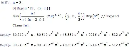

$$ \frac{d^n}{dx^n} e^{x^2} = \left( \sum_{j=0}^{\lfloor n/2 \rfloor} \frac{n!}{j!(n-2j)!}(2x)^{n-2j} \right) e^{x^2}. $$
Here is an example:
