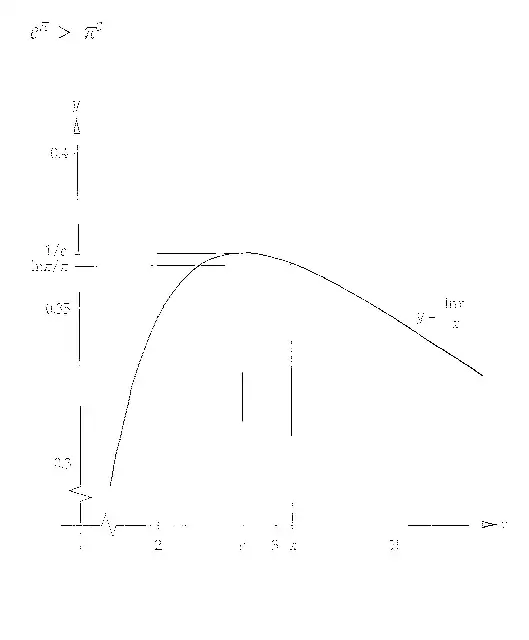

45
From Proofs without Words.

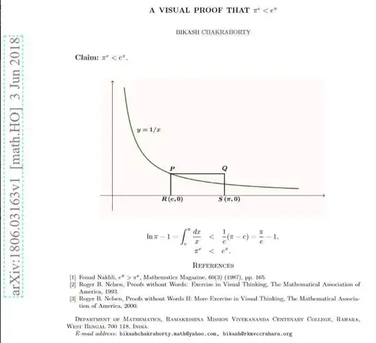

Another visual proof. Recently published in arXiventer image description here
nbsrujan
