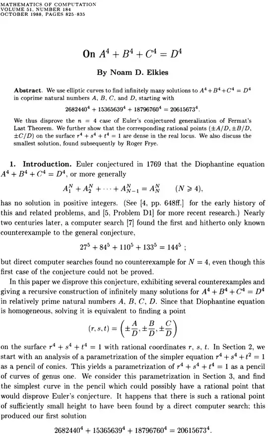

Another example: Euler's sum of powers conjecture, a generalization of Fermat's Last Theorem. It states:
If the equation $\sum_{i=1}^kx_i^n=z^n$ has a solution in positive integers, then $n \leq k$ (unless $k=1$). Fermat's Last Theorem is the $k=2$ case of this conjecture.
A counterexample for $n=5$ was found in 1966: it's
$$ 61917364224=27^5+84^5+110^5+133^5=144^5 $$ The smallest counterexample for $n=4$ was found in 1988:
$$ 31858749840007945920321 = 95800^4+217519^4+414560^4=422481^4 $$ This example used to be even more useful in the days before FLT was proved, as an answer to the question "Why do we need to prove FLT if it has been verified for thousands of numbers?" :-)

    This one I like a lot, and it's pretty simple to explain :) I also appreciate the historical background offered. – Justin L. Jul 29 '10 at 05:20
    On the other hand the numbers involved in the above examples are fairly small (compared to the millions of millions of millions). I find Justin's question interesting and I'm not sure I'm so convinced by those counterexamples which wouldn't take long to find using today's technology. – David Kohler Mar 31 '11 at 16:47
    @David: 31858749840007945920321 is pretty large, and it took until 1988. Naïvely speaking, you have to try all triples of fourth powers, with the largest number going up to 414560. Finding this counterexample, even with today's technology, would take more than a year on a desktop computer. (Of course, there are presumably number-theoretic insights which make it faster to find counterexamples by computer, but as I saw it, the whole point of the question was that the "simply try as many numbers as you can on a computer" approach need not give the right answer.) – ShreevatsaR May 10 '11 at 07:19
  • @ShreevatsaR: I edited as this question has just been bumped up anyway. – George Lowther Aug 29 '11 at 23:03
  • @ShreevatsaR: no problem. Although, now, it displays badly on my iphone as the first double-dollar sign does not get interpreted as converting to tex. Think that might be because the long numbers are interpreted as phone numbers and not as tex. – George Lowther Aug 30 '11 at 09:17
    It may be reasonable to mention Elkies explicitly here. – Mikhail Katz Aug 22 '17 at 13:05
  • @MikhailKatz Why do you say so? The counterexample found in 1966 was by Lander and Parkin (link to paper), published a couple of months before Elkies was born. The smallest $n=4$ example (not relevant to the disproving of the original conjecture; only included in this answer as additional information) found in 1988 was by Roger Frye. No doubt Elkies is relevant to the latter, but all this information is in the linked article. – ShreevatsaR Apr 19 '19 at 16:49

One of Euler conjectures was disproven with a huge counterexample.enter image description here
