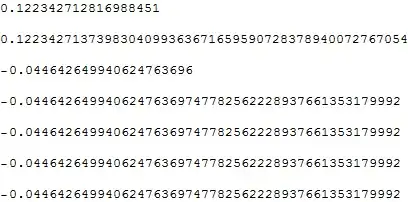

(*A certain derivative. Used in Q869502.nb*)
T[h_, a_, b_] :=
  NIntegrate[(E^(-(b^2/2) - xi b h - 1/2 (1 + xi^2) h^2)) /(
     2 (1 + xi^2) \[Pi]) -
     b  /(2 Sqrt[2] Sqrt[ \[Pi]]) (
      xi  Erfc[(h + xi (b + xi h))/(Sqrt[2] Sqrt[1 + xi^2])])/ ((1 +
        xi^2)^(3/2)) E^(-(b^2/(2 + 2 xi^2))), {xi, 0, a},
    WorkingPrecision -> 20] + Erfc[h/Sqrt[2]] Erf[b/Sqrt[2]] 1/4;
{A1, A2, A3} = RandomReal[{-1, 1}, 3, WorkingPrecision -> 50];
u = Range[0, 1, 1/100];
mT = Interpolation[Transpose[{u, T[A1 u, A2, A3 u]}]];
u =.; u = RandomReal[{0, 1}, WorkingPrecision -> 50];
mT'[u]
-rho[A1 u] 1/2 Erf[(A1 A2 + A3)/Sqrt[2] u] A1 +
 1/Sqrt[1 + A2^2]
   rho[(A3 u)/Sqrt[1 + A2^2]] 1/
   2 Erfc[(A1 + A2 A3 + A1 A2^2)/(Sqrt[2] Sqrt[1 + A2^2]) u] A3
T[A1 u, A2, A3 u]
1/(2 Pi) (ArcTan[A2] - ArcTan[(A2 A1 + A3)/A1] -
    ArcTan[(A1 + A2 A3 + A2^2 A1)/A3]) +
 1/4 Erf[(A3 u)/(Sqrt[2] Sqrt[1 + A2^2])] +
 OwenT[A1 u, (A2 A1 + A3)/A1] +
 OwenT[A3/Sqrt[1 + A2^2] u, (A1 + A2 A3 + A2^2 A1)/A3]
1/(2 Pi) (-ArcTan[A3/((A1 + A2 A3 + A2^2 A1))] -
-1/(2 Pi) Pi/2 (Sign[A3/((A1 + A2 A3 + A2^2 A1))]) +
-(1/4) Sign[A3/((A1 + A2 A3 + A2^2 A1))] +
