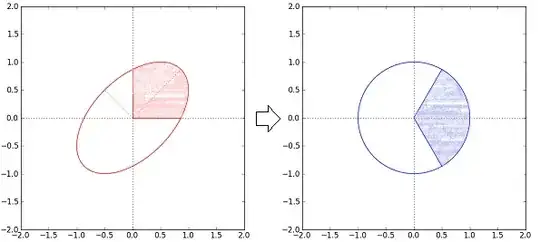

In two dimensions, the solution to the integral then reduces to comparing the area enclosed by the transformed positive coordinate axes (blue) to the area of the unit circle:
Affine transformations do not change volume ratios
