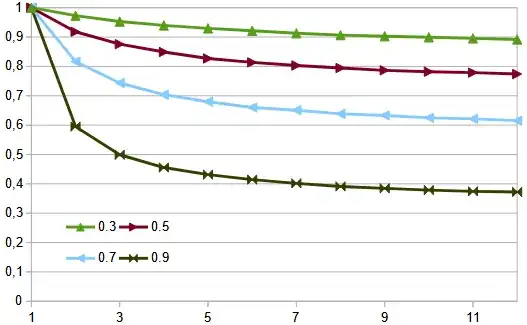

Added: from the same simulations, here are the conditional probabilities $H(\xi_i|\xi_{i-1},...,\xi_1)$ for diferent values of $\rho$. I wonder if there is non-zero limit for $N\to \infty$...
