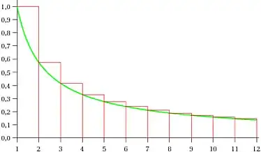

    If you alrady have Riemann integration at your disposal, then $\sum_{k=1}^n\frac1 k\approx \int_1^{n+1}\frac{\mathrm d x}{x}$. – Hagen von Eitzen Feb 17 '13 at 18:05
  • @HagenvonEitzen Is that the same as the Riemann sum? Making constant width blocks above/below the curve to show upper/lower bounds? I guess in a monotonic curve, limiting the width to $0$ should give the approximate integral. Is that right? – mayank Feb 17 '13 at 18:08
    It's an upper Riemann sum. As $\ln$ is monotonic, i.e. $\frac1k\ge \frac1x\ge \frac1{k+1}$ for $x\in[k,k+1]$, $\sum_{k=1}^n\frac1k\ge \int_1^{n+1}\frac{\mathrm dx}x\ge \sum_{k=2}^{n+1}\frac1k$. – Hagen von Eitzen Feb 18 '13 at 17:47
    @HagenvonEitzen However, try taking the limit to infinity of $\int_1^{n+1}\frac{dx}{x}- ln(n)$. It converges to $0$ and not $\gamma$! How exactly does this work? – Ambica Govind Jan 22 '22 at 18:32

Just consider that $\frac{1}{x + 1} < \frac{1}{x}$, plot both and see that $H_n$ is the area under a "staircase" sandwiched between both curves (the image shows the lower bound for a similar situation). This gives rather tight bounds on $H_n$. Lower bound and "staircase"
vonbrand
  • 27,812
    Yes, I think this is the Riemann sum - upper and lower sums should give the Riemann integral - as hinted in the comments to the question. Thank you very much, and +1 for the beautiful and easy to understand graph (and explanation). – mayank Feb 18 '13 at 17:33
    Just notice that there are "triangles" between the curve and the staircase, and you end up approximating $H_n$ as halfway between upper/lower, and get a (not so) crude estimate of 0.5 for $\gamma$... – vonbrand Feb 18 '13 at 17:37
